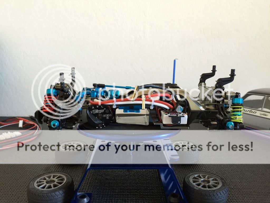

I agree with grandpa on the stiffer spring up front causing that push... I also tried a thicker oil & push came with the softer spring. I went too stiff in the rear & it caused "hop". I went back to the medium spring & 40wt with the roll bar but that caused "hop" again.
My parking lot has left me with this combo as it's not as smooth as many purpose built tracks. Obviously there are all the other factors mentioned from ride height to droop but each track will require changes so play around with the set-ups & make one change at a time
(35wt front, 40wt rear)
(Soft springs up front, Medium in the back)
3 hole piston all around & no anti-roll bars

Des- Your machine looks great! On the V2 I completely agree that the softer springs belong on the front. But the M05 is completely different. There is too much sway with even the yellow springs up front with the red springs in the back for me causing the car to be unstable while approaching a fast wide right turn and snaking through a tight right turn soon after on my basement track. I tried the blue front/red rear springs approach, but the white extra hard spring front/yellow rear has been much more stable.

Ahhh I have no experience with the M-05, just the V2 & thanks it's running & looking pretty good!
What is the rear suspension set up right now sakad?
My buddy had a terrible rear end & wander but toe out up front & stock rear uprights corrected his issue for the most part
