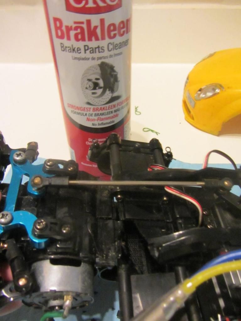

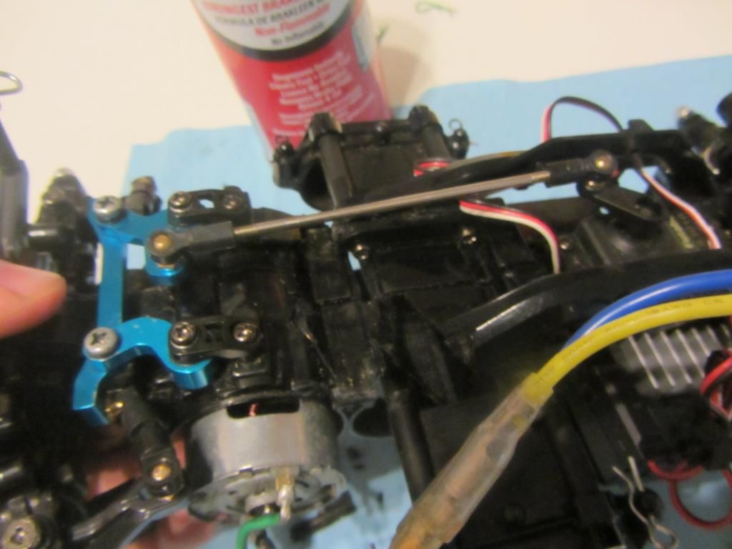

I was cleaning my M05 racer with brakekleen.... and this happened:
It wasn't noticeably broken before.. I don't think at least!
My question is:
did the Brakekleen just out and out melt the plastic parts?
or
did it find any fractures from racing crashes?

That's a real good possibility that the Brakekleen did do it
Why did you spray the entire chassis anyway?
Try getting some scrap plastic that you got and spray it
and see if you get the same reaction
Not all brake cleaners are safe on plastic.
I had a black M03 chassis turn whitish/grey and get brittle in spots, after using a cleaner on it. Can't remember which, but it was probably brake cleaner an industrial silicone spray I found at my job. I only use a non-chlorinated brake cleaner now, that claims to be safe on plastics. I still avoid getting it on the chassis though.

The chassis is very brittle ...you really have to be extremely careful what solvents, glues, and greases touch that plastic.
Brake Cleaner can now be added to the list of no no's for the Tamiya plastic chassis.
Also NEVER use any threadlock as it too will make the plastic break apart (i learned the hard way). By the way, I was using threadlock on a metal to metal piece but some of the thread lock seeped onto the plastic ...all it took was a fraction of a drop.
sorry for your lose, yet the good news is a complete chassis can be had for about $12!
I was only cleaning a nook out that was full of debris and grease. Sprayed more than I thought. Anyway curiously the parts I had replaced were not affected. The original ones did. This is a second hand car, perhaps it was crashed before my ownership too. Either way its just 2 parts racks...a whole $12 to repair :-)
