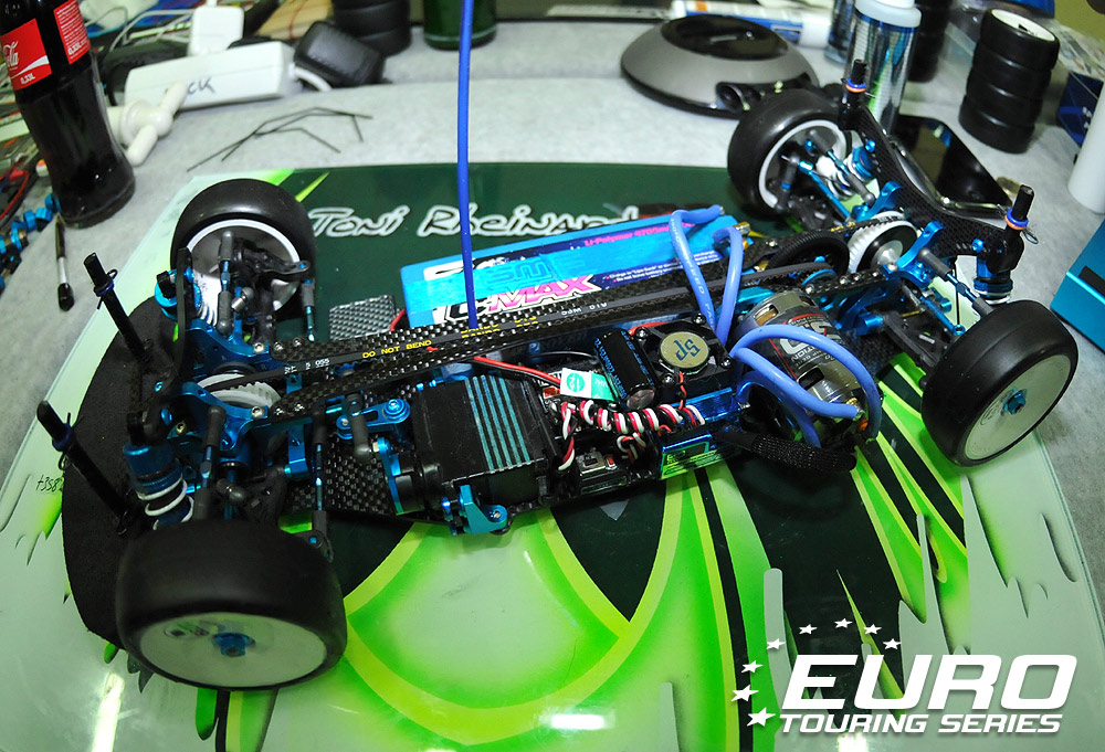

Pics of Marc's 416X at ETS... Check how close the spur is to the rear diff pulley now!

looks like he is using the 5*8mm ballconnectors in steel (or just black alu..)
where do i find the ball connectors in steel if the are availible? part number? (tired of being scared of them breaking when i get hit or hits someone)

53969 - 5x8 steel
53968 - 5x5 steel
In the steering assembly, I like to use the fluorine coated pieces that are also used as the "kingpins." They seem longer yet, and don't bend easily.
