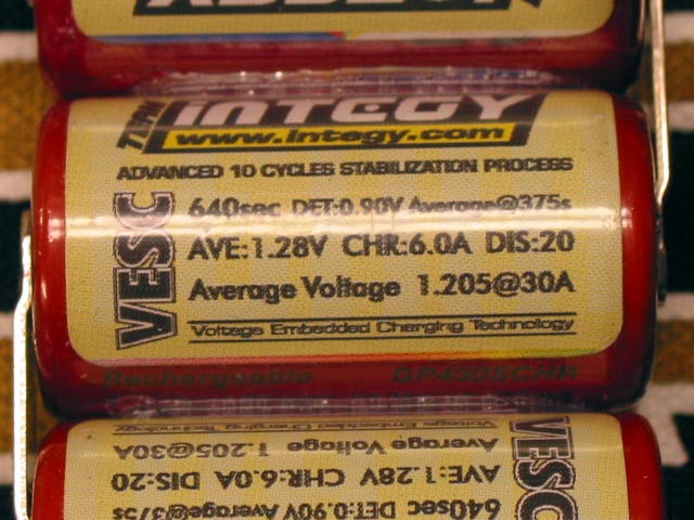

I built 2 side x side packs of These matched GP4300's from Integy and really like them. I ran some tests for top speed with GPS against some unmatched IB4200's and the GP's were +1mph faster average 2 pack vs 2 packs. I will be buying more...GP's are far more stable then IB4200's IMO.

why did you compare these matched GP packs against "some unmatched IB4200's" ???

Because those were all I had the were reasonably fresh cells, and I know they were both pretty strong packs from running them. I dont think it would have been fair to compare to and 8 cell.
Point being they are competitive enough to try and see for yourself.

those label says "DIS 20" but then says [email protected]30Amp what gives
also remarkably all the numbers on those labels are the same. somehow i think they just printed all those labels and just stuck them on

what i meant was 1 pack was matched while the other pack wasn't.....try comparing matched packs against matched packs and you'll have a closer comparison.

Yes...that pretty much goes without saying. That is why I noted that one was matched and the other wasn't so people would understand they were not a total fair comparison by matching, but actually are comparable in price.
I'm not going to go out and buy more matched IB's to compare to, so I suppose the other option is to not compare at all, and give people nothing like most of the other responces give to the topic.

From what I'm told, what they do is to match at 20 amps (which gives really good looking voltage numbers and long runtime numbers), then they "CONVERT" (via mathematical calculations) to produce the 30 amp numbers (which is NOT what they would be if MATCHED at 30 amps)... Note that the middle line says 1.28v ... at 20A, while the bottom line says 1.205v ... at 30A.
Not "wrong", just not normal practice, and it tends to fool the new racer... (just my opinion, but I've seen it happen locally)...
