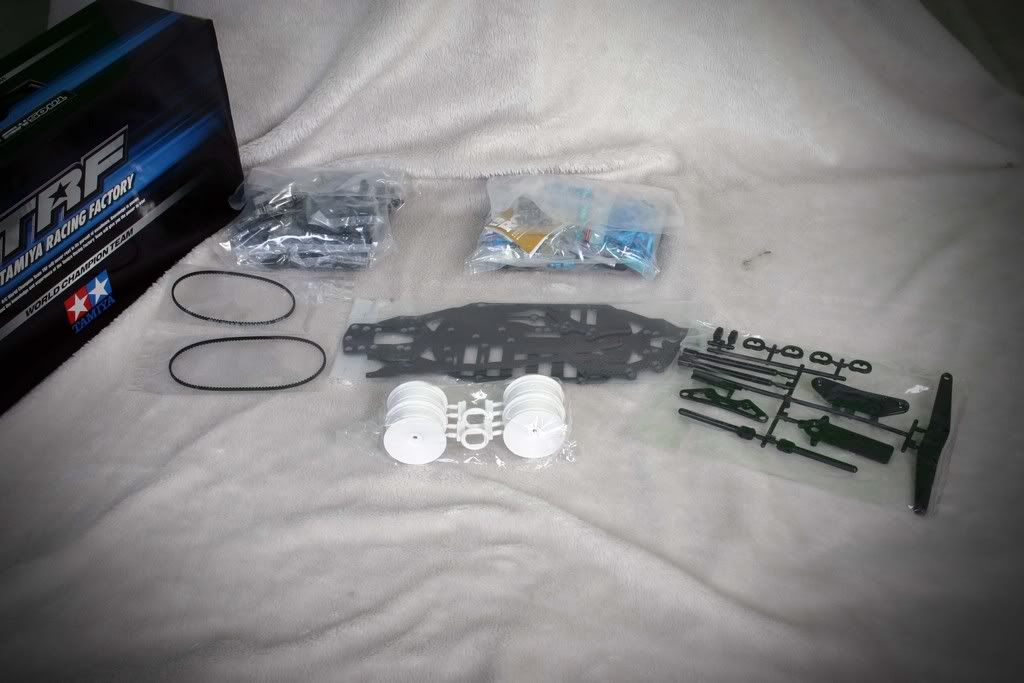

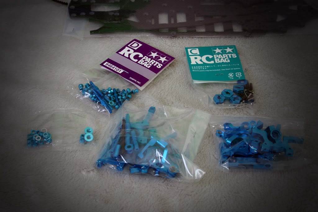

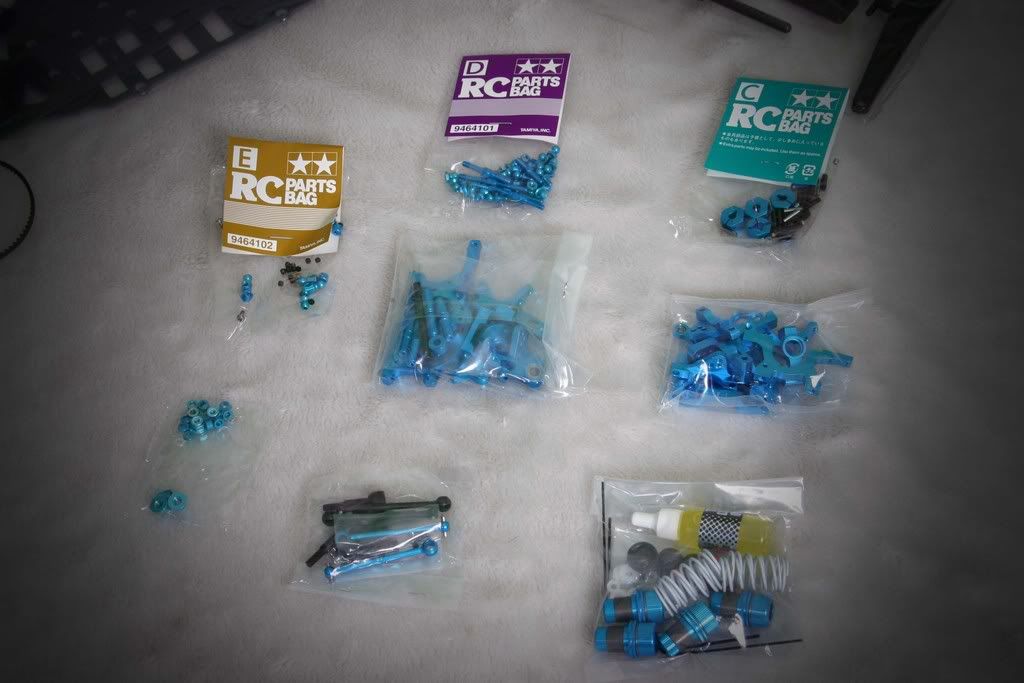

i already got the pachage. wooooo.
here are the teasers. warning: pics are a bit large

Wow!!! You already have it... Congrats...
