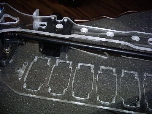

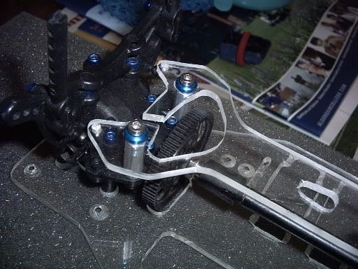

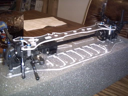

Well, here's my efforts so far...
I still need tons of parts before it'll be ready to hit the track for testing, but it sure looks nice.

damn man. thats nice props to you. you blew my chassis out of the water.

Originally Posted by RCSteve93
Did you use a CNC machine?
I didn't use a CNC machine, just a home-made template, a scroll-saw and a dremel... not to mention a very good eye and an extremely steady hand. ( I'm a perfectionist. )
I'm glad that you all like my efforts so far. Sadly though, it wasn't until I removed the masking tape from the lexan that I noticed the break in the top deck. Luckily, I've got a second chassis in the works as my plan was to use the first one to work out the positioning of all the proper holes for mounting everything.
And just to prove that it's not perfect... ( I really wish that I could've gotten the battery slots beveled better. )
