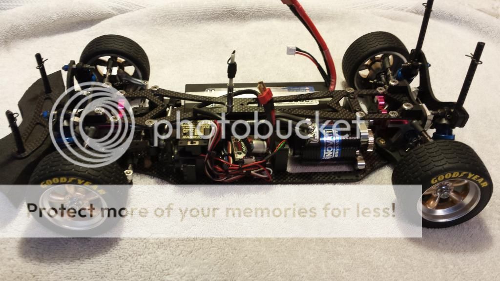

Found this chassis brand new for $160.
I wonder if it would be still competitive in 17.5 stock class?
EDWARD2003 is offline   Reply With Quote
Yes...
