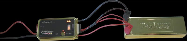

Originally Posted by MR JOLLY
MR BLACK where are you
got a balencer (pics to follow) proper made up one to fit the orion connections
it`s a charge through balencer
so got me 4800 back out & when it starts to charge the pack is taking like 4.6a & the pk is showing 8.3v
then the balencer cut`s in & shows ;voltage Error, open circuit `
do you reckon some things gone wrong inside the pk
What balancer did you get? have you contacted the maker of this balancer?
What charger are you using? 4.6A is a bit high if you are charging at 1C and the charger detects the capacity automatically it is thinking you have a 4600mAh back?
PROPEAK PRODIGY II
set it too 4800 capacity ,then it goes into 4.8a till the voltage gets near the 8.4 mark then drops down till 1 a like /like it has done for ages then the li-po went soft
anyway back on the li-po band wagon after a little rest
this is the platinum orion 4800 that i have
http://www.trakpower.com/
no to contacting
but i will go up the LHS in the next coouple of days to see what they think
i`m a bit scared it`s taking 4.6a when the batt is regestring 8.3av all ready

MR JOLLY,
That Trakpower 4900mah pack is not made by Team Orion. Still going at 4.6a when the voltage is 8.3 doesn't sound right at all. It should be way under 1 amp by then, I think. Hopefully, the reading was wrong. Is it easy to open up the case of that pack? If you can check inside, can see if the battery has swollen up or not. But you are right, the best thing to do is check with the LHS.

Originally Posted by sim600
MR JOLLY,
just the balencer
don;t have the gold bar i have a platinum one instead
nope you read it right
this is why i'm on here ,don;t want any accidents
