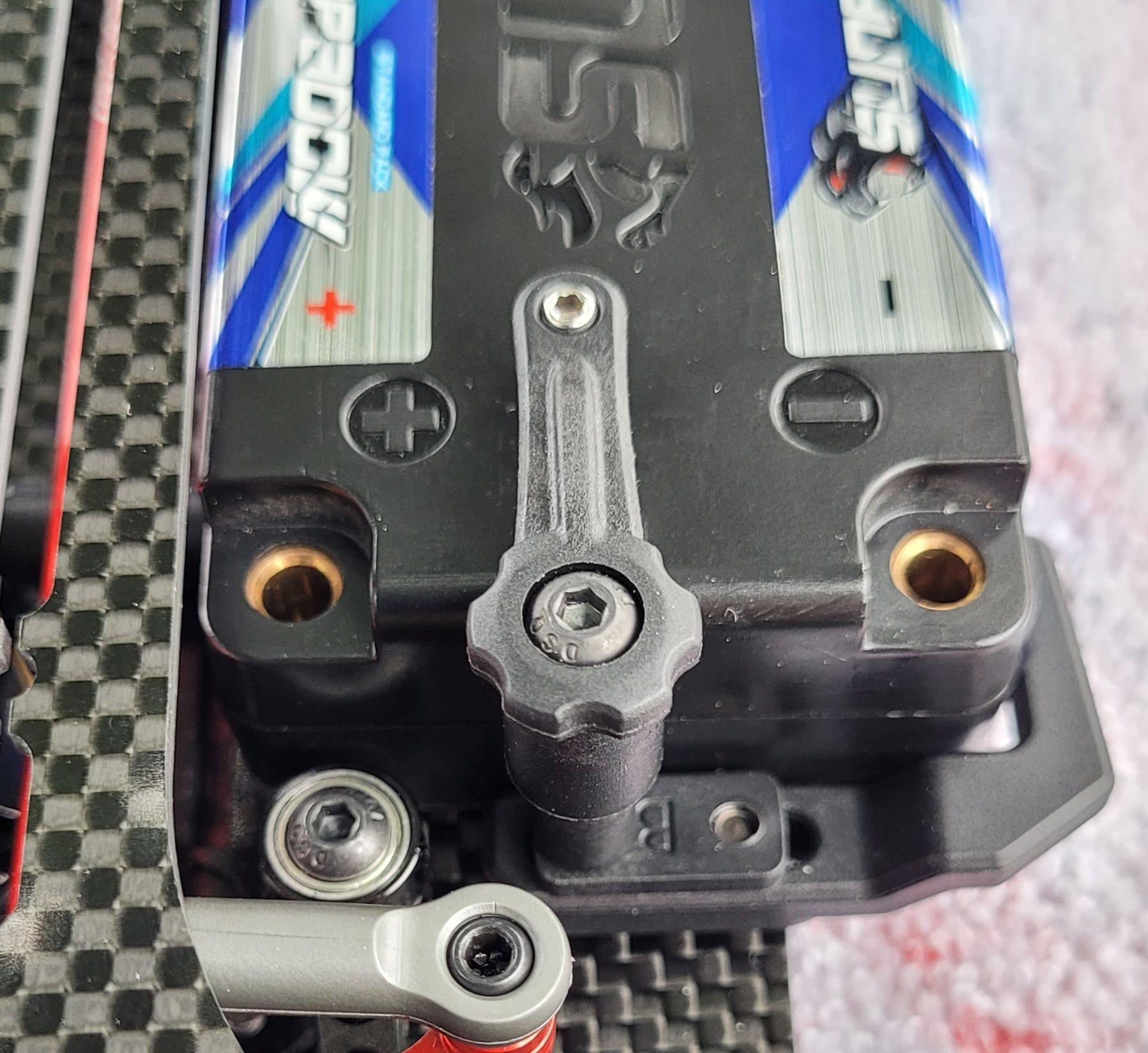

Drilled through the battery stop...
Needed a little adjustment to make the battery placement perfect
I did the opposite. Shaved down the face to move the battery further in.

I recommend moving the front battery post/retainer to the inner position for less interference during chassis flex. You can notice a quite a difference flexing the chassis in your hands between the two positions.
I didn't want to run the battery askew... just couldn't stand it being crooked.
The manual already specifies to place it where you have.
I moved it in at the rear as well, so it's not crooked.
... quickly re-checks the manual for the 7th time - OMG 😊

I was told to leave 0.5~1mm between the top of the battery and the tip of the stopper arm to leave room for chassis torsion in curves.
