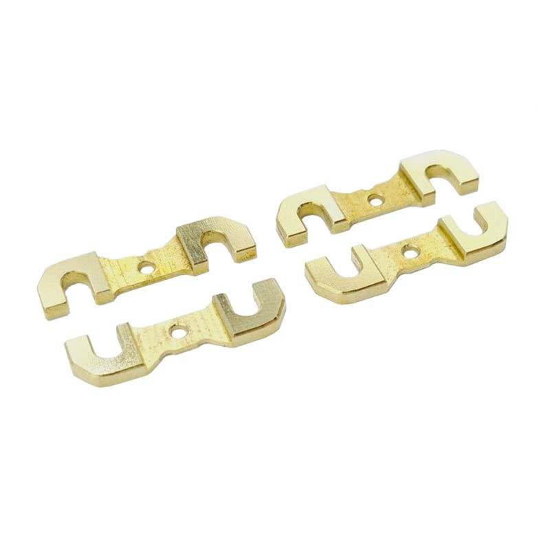

You could use larger diameter SHIMS on the lower arms to spread the force (default shims that come with the Mi8) but the better option would be perhaps make a shimming plates similar to what RCMARKER has done for the AMX or X4 Kits. The wider shim block attaching for both pivot balls will strengthen the chassis and impact points. I am hoping an aftermarket company will make these plates as it makes roll center changes much easier and less time consuming to change.

I was referring to an aftermarket company making these for the mi8

h2e, I agree. In a crash something has to give. It's unfortunate that the chassis is the first to go but I get it. The plate like shims would seem to be a better option for shimming. Well I will be trying my car for the first time this weekend on black CRC carpet. I have the alloy chassis so I should be fine. Excited to see how it compares to my A800MMX.

The bigger the shim, the wider the area the force is distributed. I am pretty sure if those types of shimming blocks where used, the screw would break or bend, or the arm would crack instead of the chassis,

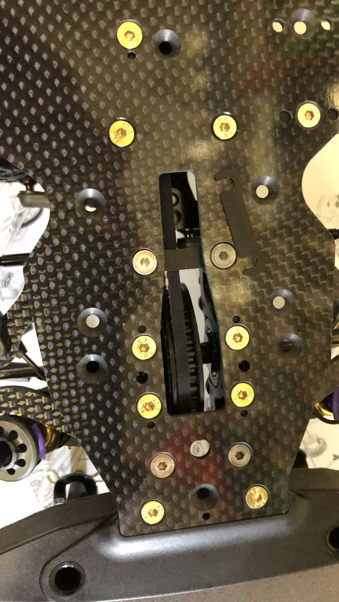

The MI7 spacers will fit the Mi8. However, this will alter the flex (a little)

Looks pretty close to the belt. How much clearance is there?
