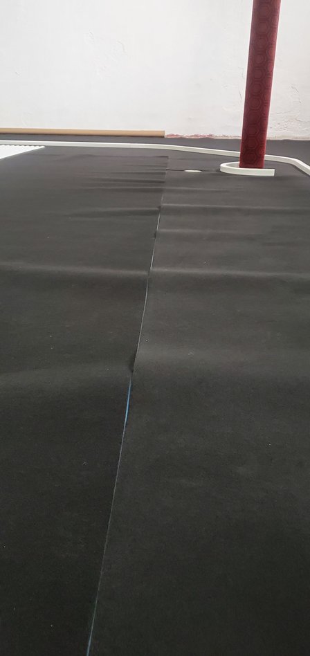

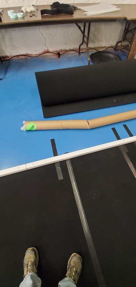

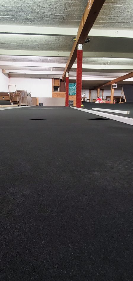

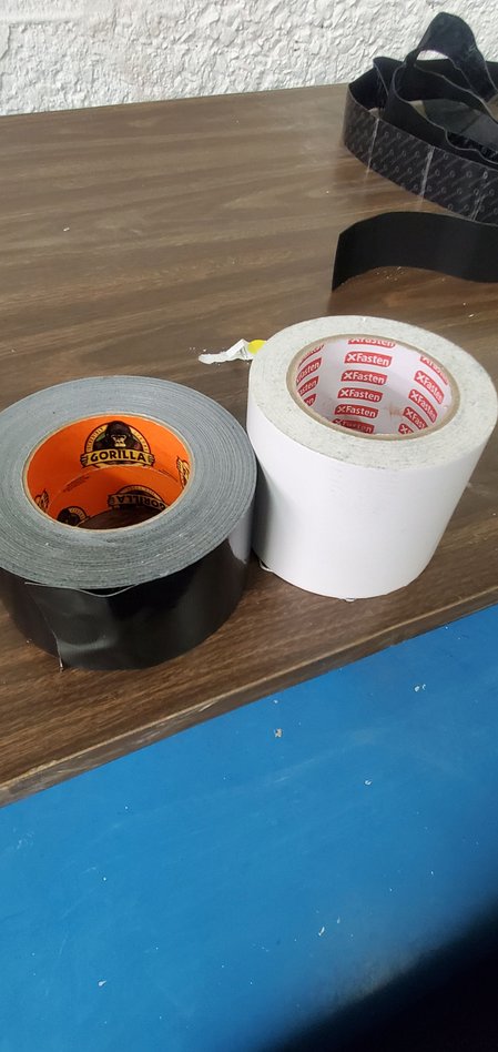

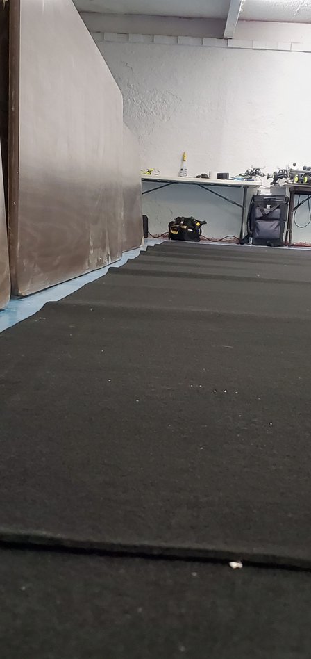

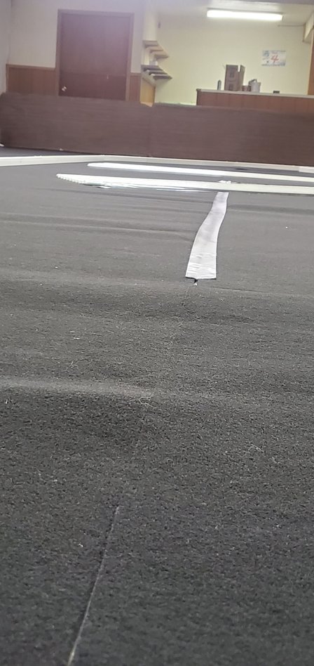

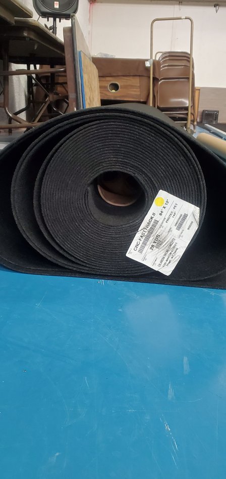

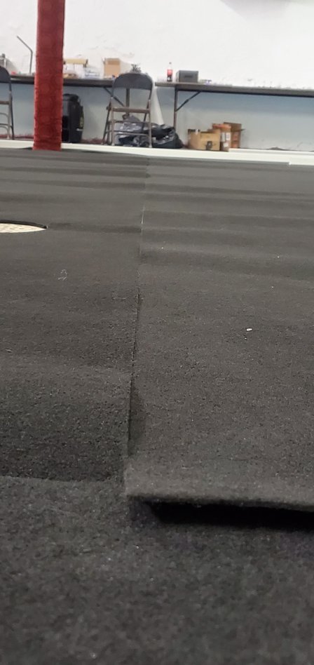

Hello, I recently purchased 3 new rolls of fassttrack II carpet from CRC. I'm having trouble getting it to lay flat. It's going on a smooth surface that used to be a skate rink. I'v tried anchoring it on both ends to get the seams flat. I tried both industrial carpet convention tape and wide gorilla tape on the underside of the carpet. If I get it remotely flat it comes undone and the bumps are back the next day. I for a fact have the race surface on top so that's not the issue. I'm wondering if anyone has had similar issues and how it was corrected? I'm out of ideas. Please help. Thanks.
I know the carpet at Snowbirds a few weeks ago was noticeably thicker than previous batches and was told it was more difficult to seam...

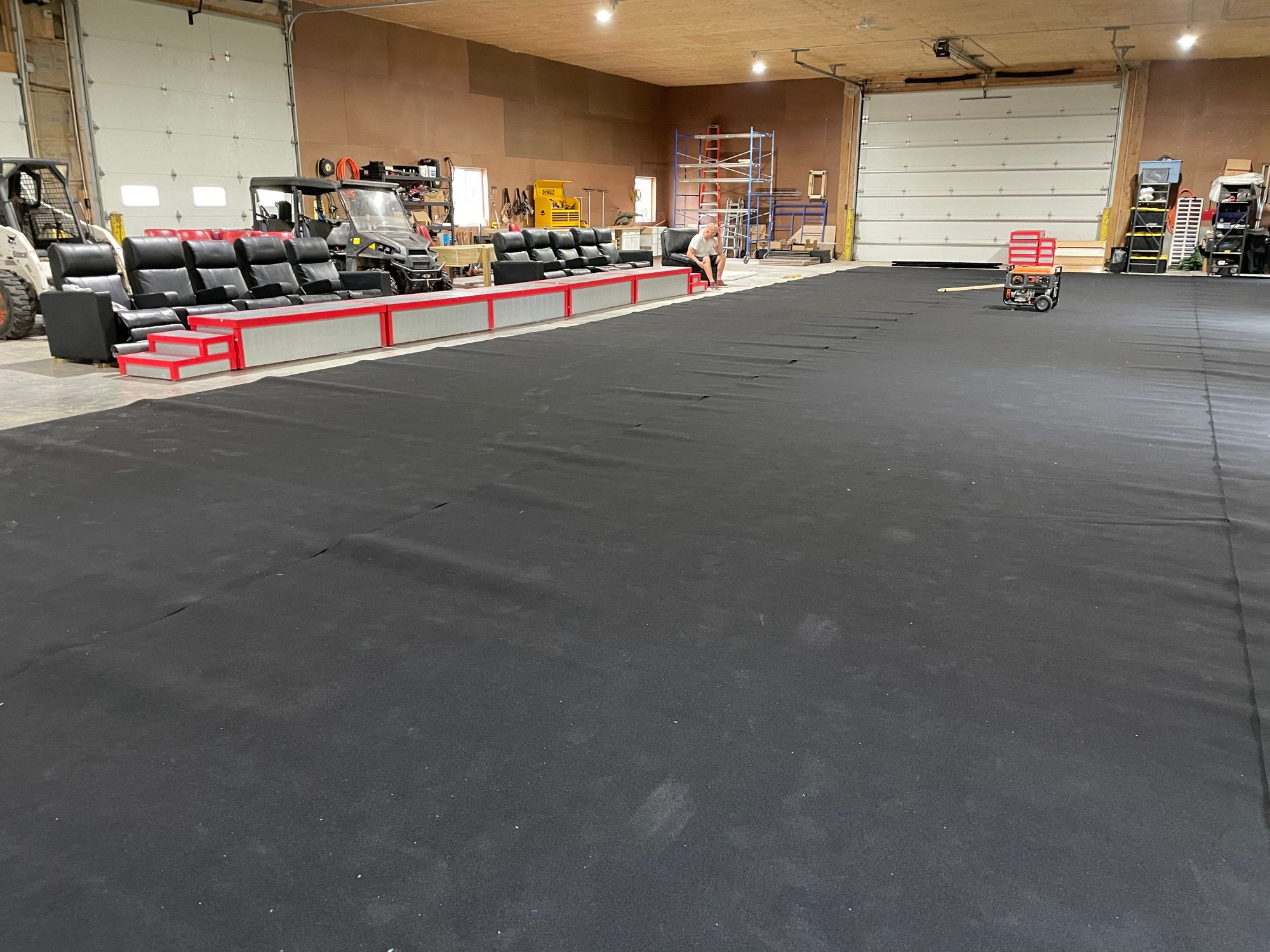

we also have three rolls of CRC carpet unrolled for 5 days now hoping it would flatten out. Not successful. Did you ever get it to work and if so how?

Gonna have to stretch it out.

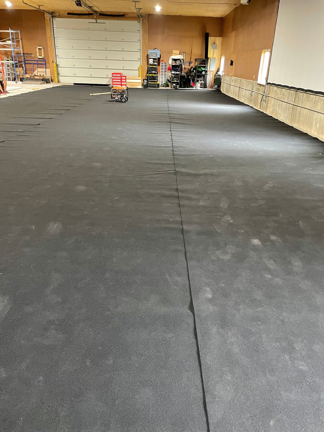

Fix one side to the floor or subfloor, wrap the other end around a 2x4, pull and strech the carpet and attach to the other side of the floor or subfloor. Use carpet tape under the seams. That is what we did for ours, but we leave it down as a permenant track. Not sure what to use for a temp laydown though. We screwed the carpet ends down with large washers to the subfloor.

We got the carpet to lay down flat. We used double faced carpet tape under the two seams. Started at one edge of the center section, doing about 8-10' at a time. To remove the edge lumps, we used an ordinary steam iron, set on steam. wool setting, to iron the carpet from about 3' off the seam towards the seam on each of the lumps. Yup, like ironing your shirt, only this was a 2500 Sq ft shirt! Two afternoons on hands and knees with steam iron did the trick. You must keep the iron moving, as if you leave it in place too long it can melt and image of the iron into carpet.
