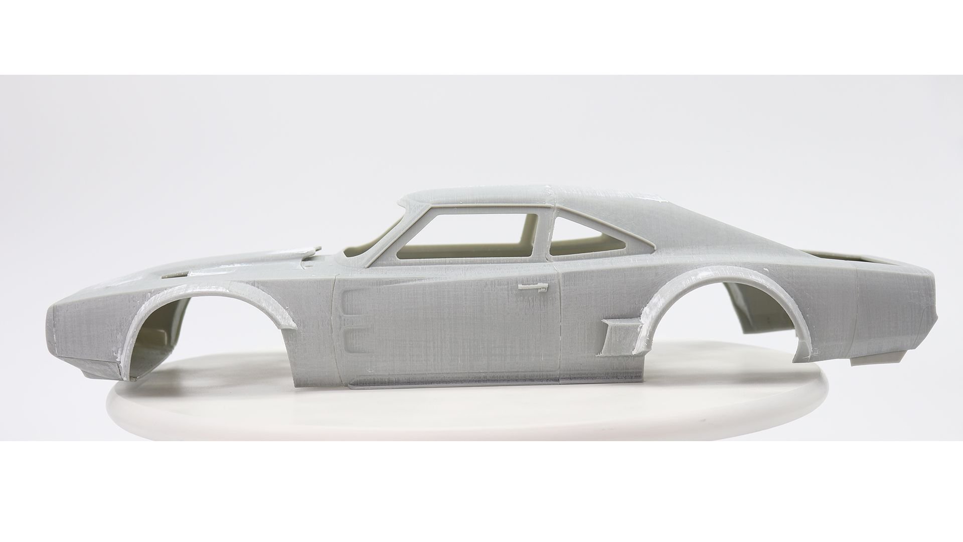

Hey Guys,
We started to build this MovieStar!!! We've already printed most of the parts and started to put it together
We use gel SuperGlue on the attaching lines.
We use liquid SuperGlue on the surface.

Are you using the liquid super glue as a filler for the 3d print lines?

Hello IndyRC,
we make the surface even with sandpaper and use a putty from tamiya to fill the cracks between the printing layers and the another sandpapering. After the first paint we also make sandpapering.
