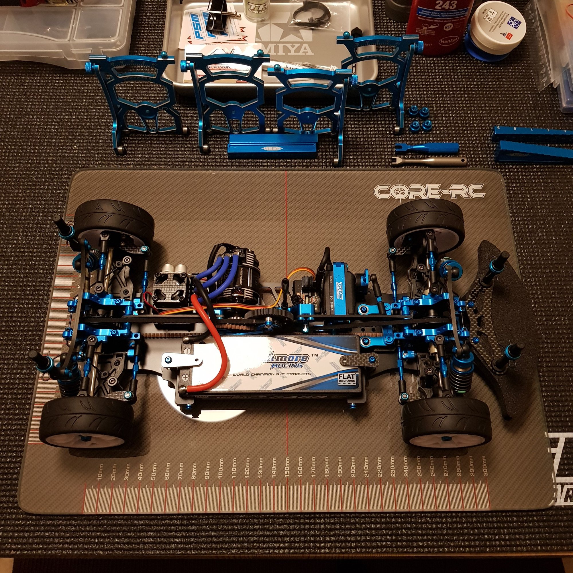

With my setup I had to add 20g on the front (2x10g 419 weights) to make race weight of 1320g.
Still need to test the car, if too much steering will probably switch to 5g on front and brass suspension mounts (~15g+) for the rear.

Default Comparison...
TA07MS vs. TA07MSX

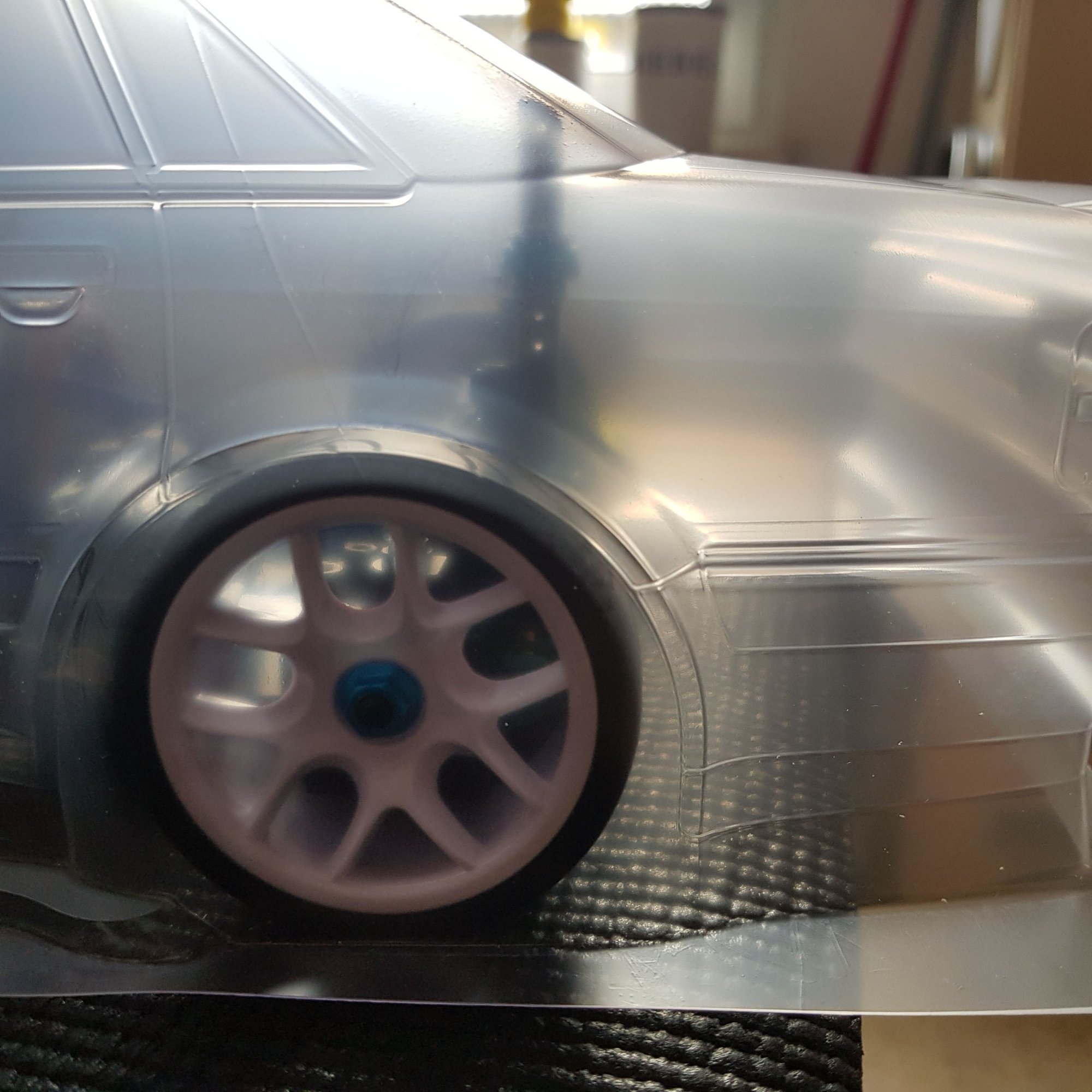

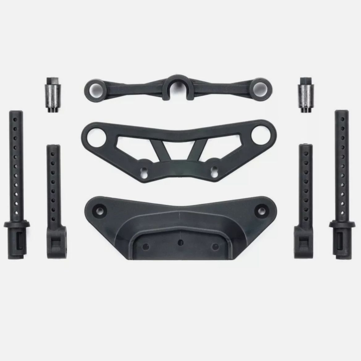

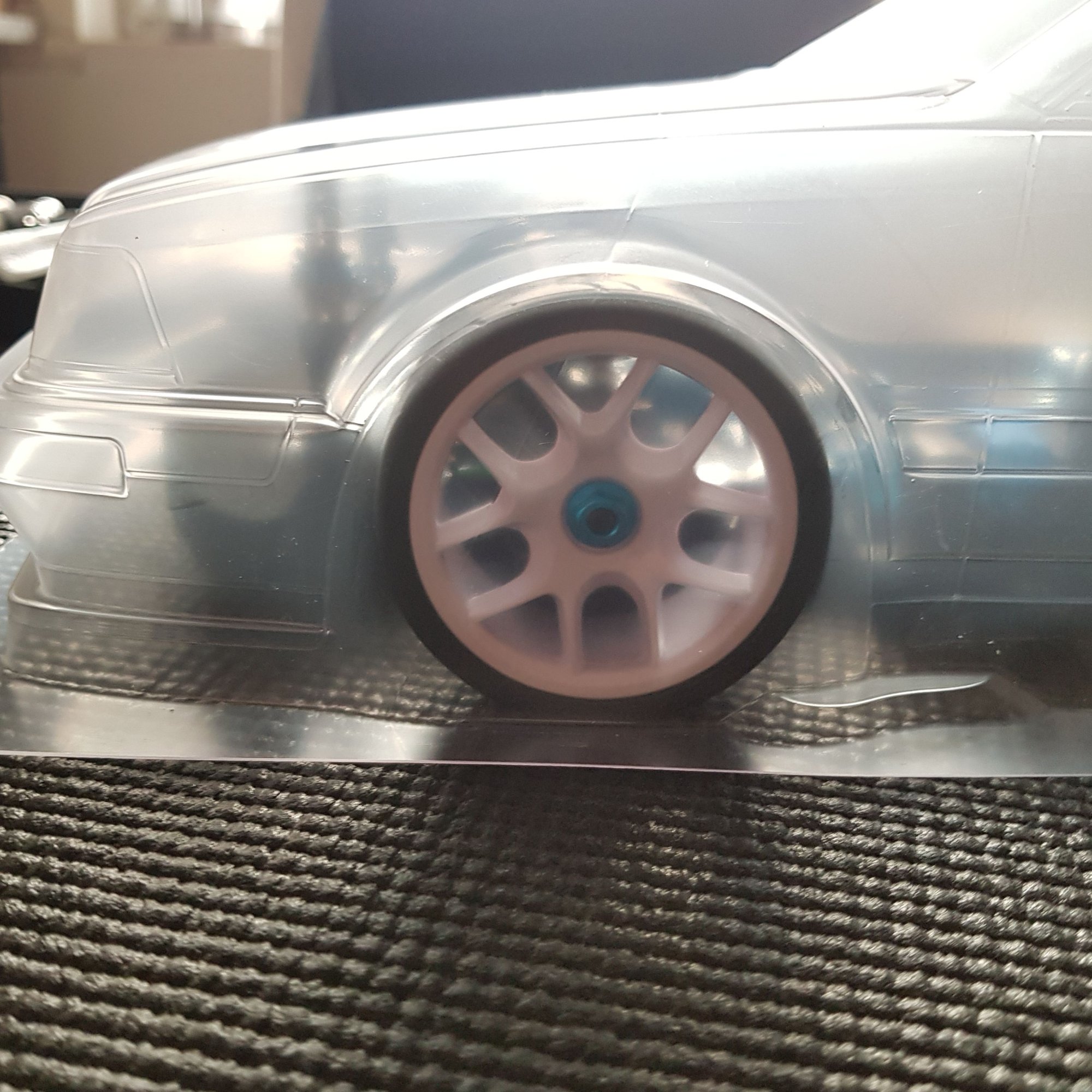

Default Design flaw
There is strongly an update of the new TRF420 parts needed...
They are way too short and not even compatible with Tamiya's own shells.
What has Tamiya thought, while designing it? That everybody is only using this freaking shitty bubble canopy racing shells???
Has a anybody experienced the same?
Is there a solution?
The old B-parts work only for rear, as the front has now extended hexes...
Tom1977 is offline

Originally Posted by C van der Hagen View Post
#54604
Yes, I know, but they are way too fiddly and flimsy...
I have them in my spare parts box.
But thanks for the hint. I hope they update the B-Parts.
