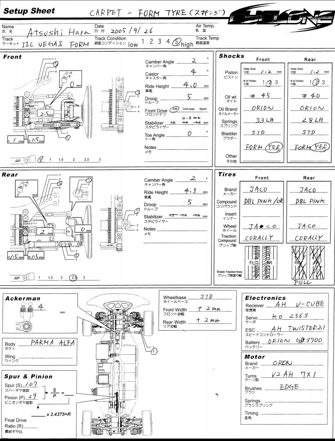

Magnificent find! thankyou ever so much!
Anybody got any idea what the receiver was? An own-brand KO unit ''AH V-CUBE

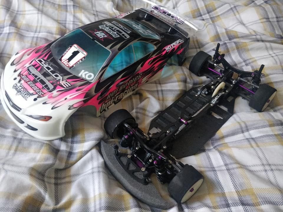

So, It has landed in the UK. its still in great shape as you'd expect from a car which has sat unused in a display cabinet.
My assumption is that its his mod foam car but the body is his mod rubber winning body

It does not look like a Parma Alfa indeed...

Awesome build! Keep it up, we need more of this in RC
My guess is he had to run a Parma Alfa as it was the hot ticket at he time on carpet with foam. But when the car went on display he left it in the states with the Ride Accord for contractual reasons...i.e. he was sponsored by them.
I've done an in-depth look at the body and chassis on my Facebook page, there's still some secrets about the car I'd like to uncover like why its fitted with a non-Cyclone rear ball diff. https://www.facebook.com/benchracer1
