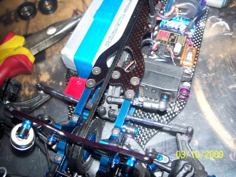

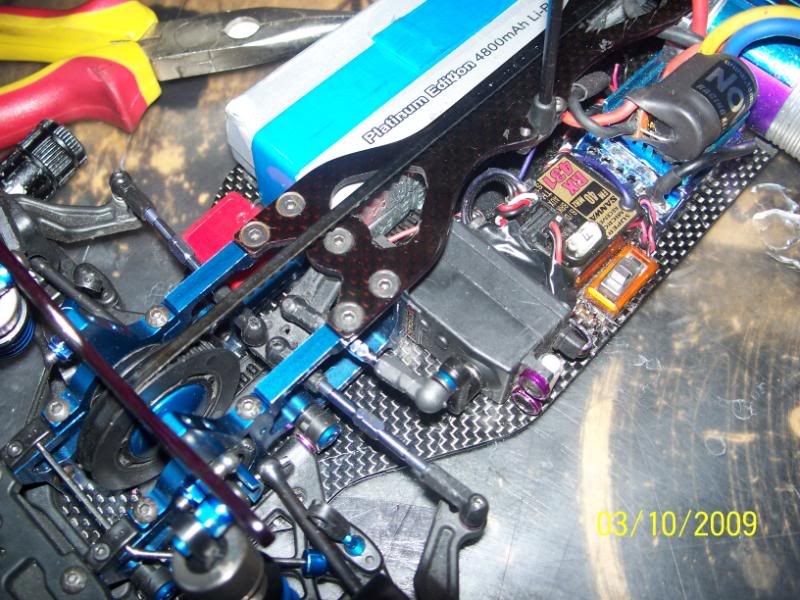

Originally Posted by Quiet Storm View Post
remove your sevo and akerman assembly
shave off the existing servo link mount
(Where your steering link used to snap on)
Carefully drill a fifth hole in the akerman using an 1/8" drill bit, centered left to right
(it should be drilled behind the existing holes, Besure it will clear both tie rods when steering extreme left and right)
Place your servo so that the horn is furthest from the Bulkhead(closest to the tire)
Carefully mark the center of each hole of each servo mounts (mounts should be fasten tightly to servo)
Drill out marks with an 1/8 inch drill bit (drill slowly as not to flake the fibre when penatrating bottom of chassis)
With a counter sink bit (lowes,home depot) counter sink bottom of chassis
Install akerman and servo adjust linkage as needed
Good Luck!
Very important!!!! You must use servo saver type servo horn!!!!!
