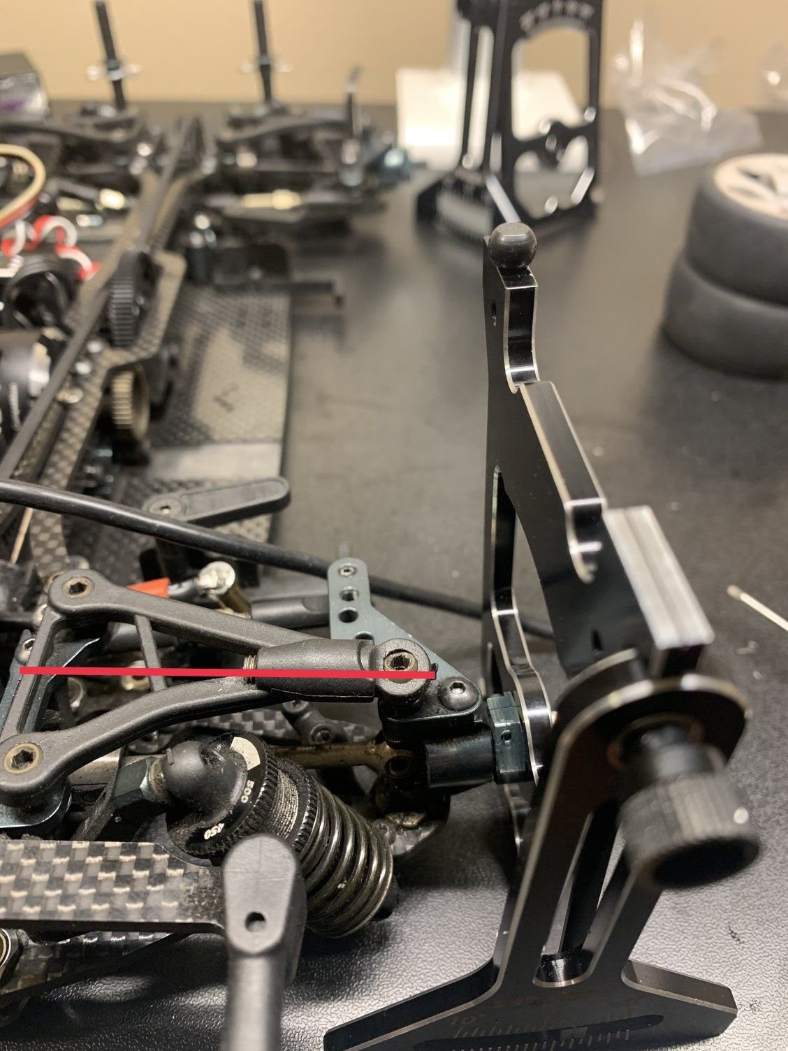

I can’t imagine what im doing incorrect. My rear left arm won’t allow more than 1 1/2 degrees camber. I’ve removed the screw to allow it to bottom out and still no change. All the other arms adjust fine except this side…
Your left rear reads 3 degrees camber. You might be reading your set up stands incorrectly, each hash mark is 1 degree.
NutDriver likes this.
trigger is offline
Old 10-30-2021, 07:03 AM
  #790
illmatic94's Avatar
Join Date: Apr 2011
Location: New York
Posts: 1,411
Trader Rating: 12 (100%+)
…. Those aren’t half marks?
illmatic94 is offline
No. Each mark is 1°. Easy to figure out: one end says 0° the other says 10°. Count the marks in between.
yeah I realized that after I posted it… man I have a lot to learn. No wonder my tires wear so quickly 😅
dawgmeat likes this.
never the less why am I able to have one side stop at 3 and the other go past

Originally Posted by elbicho View Post
I would measure that on both sides.
I did I did I’ve thought of everything. I’ll try again I could only imagine something is bent or some how some of the parts are L or R specific and I have them mixed up
