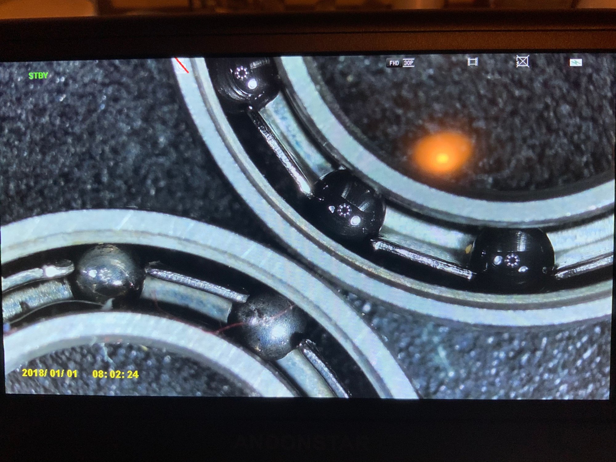

bottom bearing is 6 months of use. brake cleaner and oil. top bearing is brand new. it also happens to be ceramic. its pretty amazing how scratched up bearings get. but that could also be the brake cleaner. by the way. I used a stronger solvent on the used bearing just to see if brake cleaner was doing a great job. the stronger solvent pulled allot more crap out of a bearing that was cleaned with brake cleaner and air first.
I melted ceram speed grease into the upper bearing and installed today. ill check in a couple of months. it takes about 250c to get the grease to flow into the bearings. the greased bearings also had more resistance than oiled.

I change bearings when I get about 1/2 to 3/4 a degree of slop (camber) as measured on a setup stand. the ceramic bearings have less play to begin with and they really arenít that expensive.
Bry195 is offline
