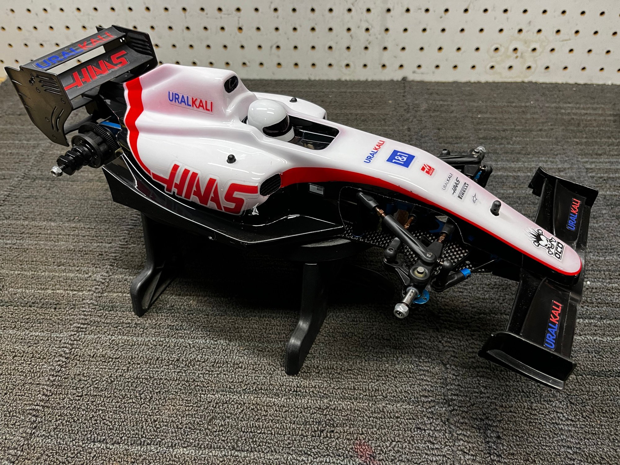

Posts: 167
That info above is good to know.. I’ll need to make changes before I hit the track 😬
Anyone put a halo on the Exotek body? Pics and info where to buy one please….
Getting closer, got the body done today 🏁🏁
sweet. re-up when you put wheels/tires please
