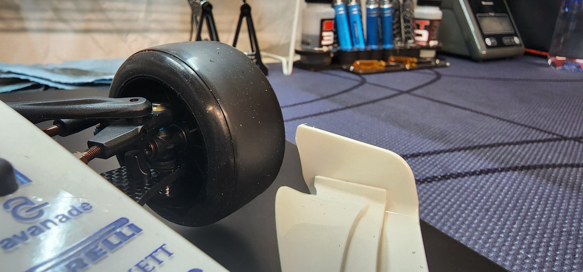

Anyone having the same problem where the exotek tires hits the new 2022 style front wing when turning??

How many races on this front tire?

I hope not. Just ordered this wing. Will install tomorrow and report back. Looks like maybe you can trim that little extension on the winglet for clearance?

Are you running long or short wheelbase?

We rarely race F1 here but a lot of us run F1s. Theres at least 12 packs through this set.

Thats what i did, trimmed the winglet back a little until it cleared.

Im running long wheelbase

Installed the 2022 Montech front wing. It cleared, but only by a frogs hair. Went ahead and trimmed the point to increase clearance.
