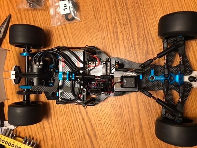

Ok, got electronics in this thing finally. Sanwa Super Votex Gen2 Pro without fan, Sanwa 482 reciever, KO response RSx3 servo. And Reedy 25.5 motor and Orion LCG battery.
is there a video or something other than the one confusing pic in manual(that doesn’t tell you how to hold the car) to measure side shock droop? I see where you are measuring it, but does the rear pod hang, or ? I’m lost here. LoL

Well, I took the Ultra F1 to the track tonight with little expectations due to there being several fast guys there every race. I threw the thing down with Arrowmax 24R tires and it was terrible. LoL
so, I switched to my TCS tires on the rear, and shortened up the center shock, put on the soft black side springs and added a little preload in the side shocks, added a little caster by shortening the gap at the turnbuckle 1mm to 7.5mm. Put the factory front springs on, .5mm droop up front and .9mm droop at side shock eyelets. 5mm ride height front to rear. Loosened the diff a bit till it slipped for 3-4 feet. The car came to life. i went from terrible and in last after 1st RD, to second place qualifier in the second round. And I ended up winning the A-main.
I will say that the front ball cups are not very good. After just a few races they are sloppy! So I have the Tamiya 53601 cups ordered. My high dollar servo felt like a $20 plastic geared Hitec all night. LoL drifting left and right all night down the straight.
mocrawlin is offline
