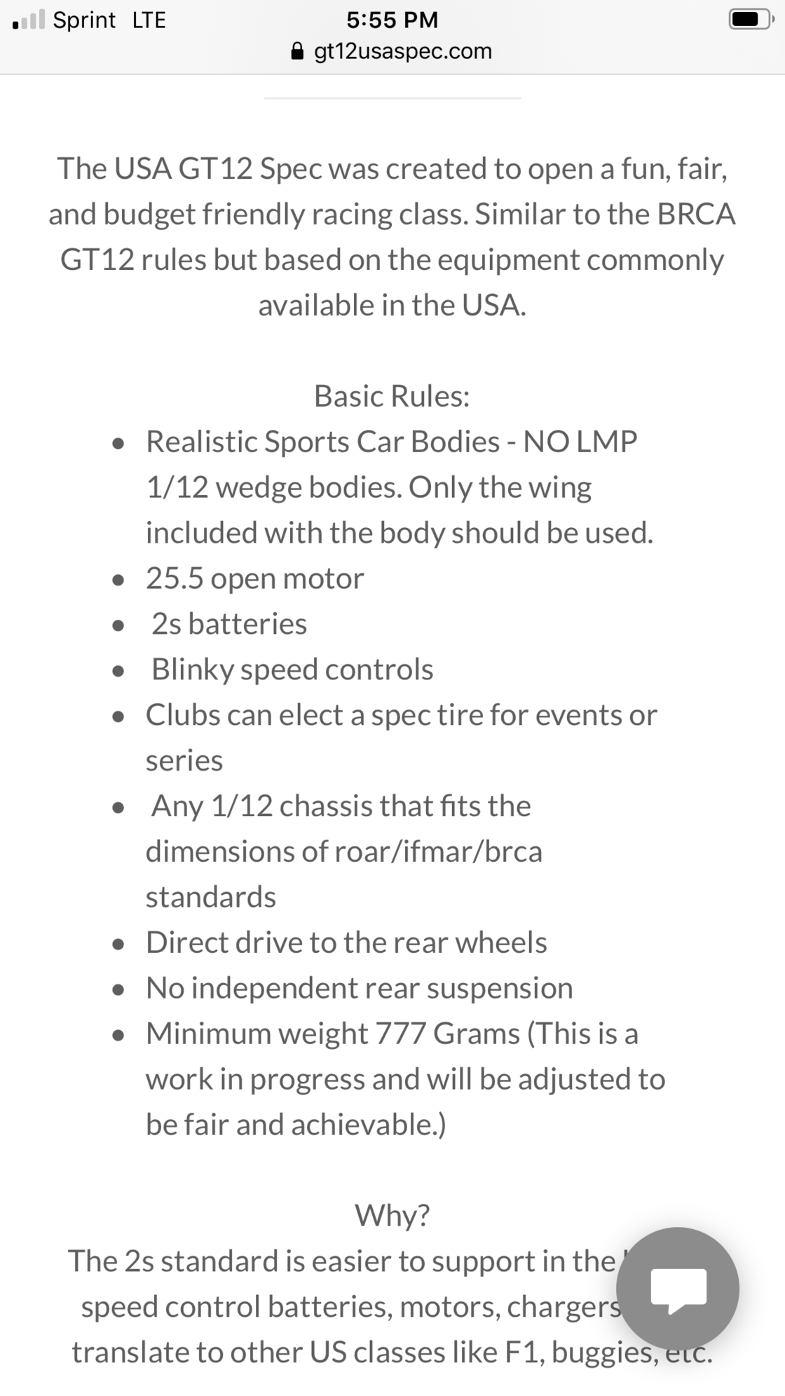

We've been running Gt12 as a class at 702 Rc Raceway recently. It was on the uptick then quarantine happened. Now that we're back its running again and growing every week. With cool bodies, easy to drive and maintain cars, and speed its been both fast and furious. What is hasn't been is a lot of drama and issues. We put together a facebook group and website with our basic rules to try and keep it going and hopefully help some other clubs get the pan cars dusted off.
With rubber tires around the corner or on the UPS truck now is a great time to get fair, fast, and affordable racing going. Take a look at the site(https://gt12usaspec.com/) and lets try to compare what other clubs are doing so we can try to come together as a community with some shared knowledge and best practices.
Here are the basics:
Blink Speed Control
2s battery
25.5 Roar approved motor
Sports Car Body
Open tire but the Gravity White Stripe has been our go to.

Any reason for 25.5 instead of 21.5?
Click the link they posted. Gives a more detailed explanation. I copied this for why they picked 25.5.
Why?
The 2s standard is easier to support in the US, the speed control batteries, motors, chargers easily translate to other US classes like F1, buggies, etc.
The lower torque of a 25.5 motor with 2s is drive-able and fast but with a shorty low profile battery easily fits in most available 1/12 chassis.
dman18t likes this.

Hanulec - 25.5 is just a bit slower and easier to drive. Most of the drivers attracted to this are sportsman or novices. Also because of F1 and VTA there are a lot of 25.5's laying around here. I tested with 21.5 lap times were consistent with 25.5 and a touch faster with 21.5 but would be harder for a sportsman or novice racer.
1s Support - It is moderately harder to support. Why? Almost all of us had an extra battery, motor, and speed control around. I've had extra motors to give away that were my back up to the back up. At a time when a lot of us are stretched for race bucks its just easier to get started with 2s. The equipment then easily transfers to other classes like F1 or VTA if you move on or over to this. There aren't any 1s speed controls really just lying around our pit boxes or as easily available. The 4 1s speed controls on A-Main are 2x-3x the cost of a Hobbywing Justock. Its about what you can reuse and get easily, for us here in Vegas 2s 25.5 made the most sense. We tested it, it was fun. We raced it, it was more fun. Now we're trying to help other people have fun...
If you like the old formula race it, enjoy it. If you want to try this, please do and provide feedback.
As far as they name if the BRCA objects sure we'll change it, but I think the distinction is made with the USA Spec.
