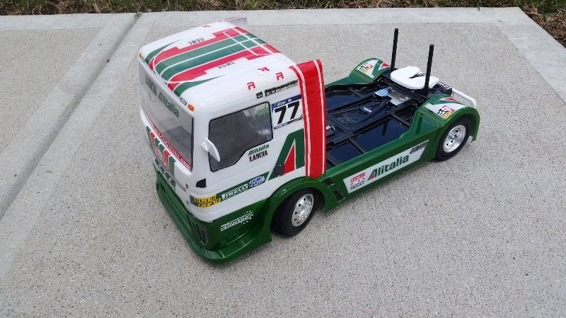

I ended up with an extra set of the HPI Lancia Stratos decals and I ended up using them on a Tamiya Eurotruck. Here is a pic.
