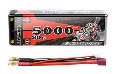

I am not a fan of the Castle or Traxxas brushless motors or speed controls. They are fine in a Slash or some of the other basher type offroad vehicles, but I personally would never use one in a proper sedan like that Tamiya TB-04R.
It is always best to use a hard case lipo pack in a sedan as they provide some measure of added protection should there be a crash or impact. There is nothing worse than a lipo fire and they burn white hot and water will not extinguish the flames. Traxxas uses their proprietary connector that works with their specific line of chargers. Again, fine for an offroad basher, but a bit clumsy in a sedan. I use 2S lipo batteries that have 4mm (or 5mm) female bullet connectors built into the pack. On my speed controls, I add 4mm (or 5mm) male bullet connectors and plug directly into the packs.
I have been using economical Goldbat 5000mah 80C 2S lipo packs I purchased off Amazon.ca for $38 CAN per pack. Maybe not the best of the best, but they work perfectly fine in my Tamiya TA-05 Ver.2 sedan and they are affordable.
