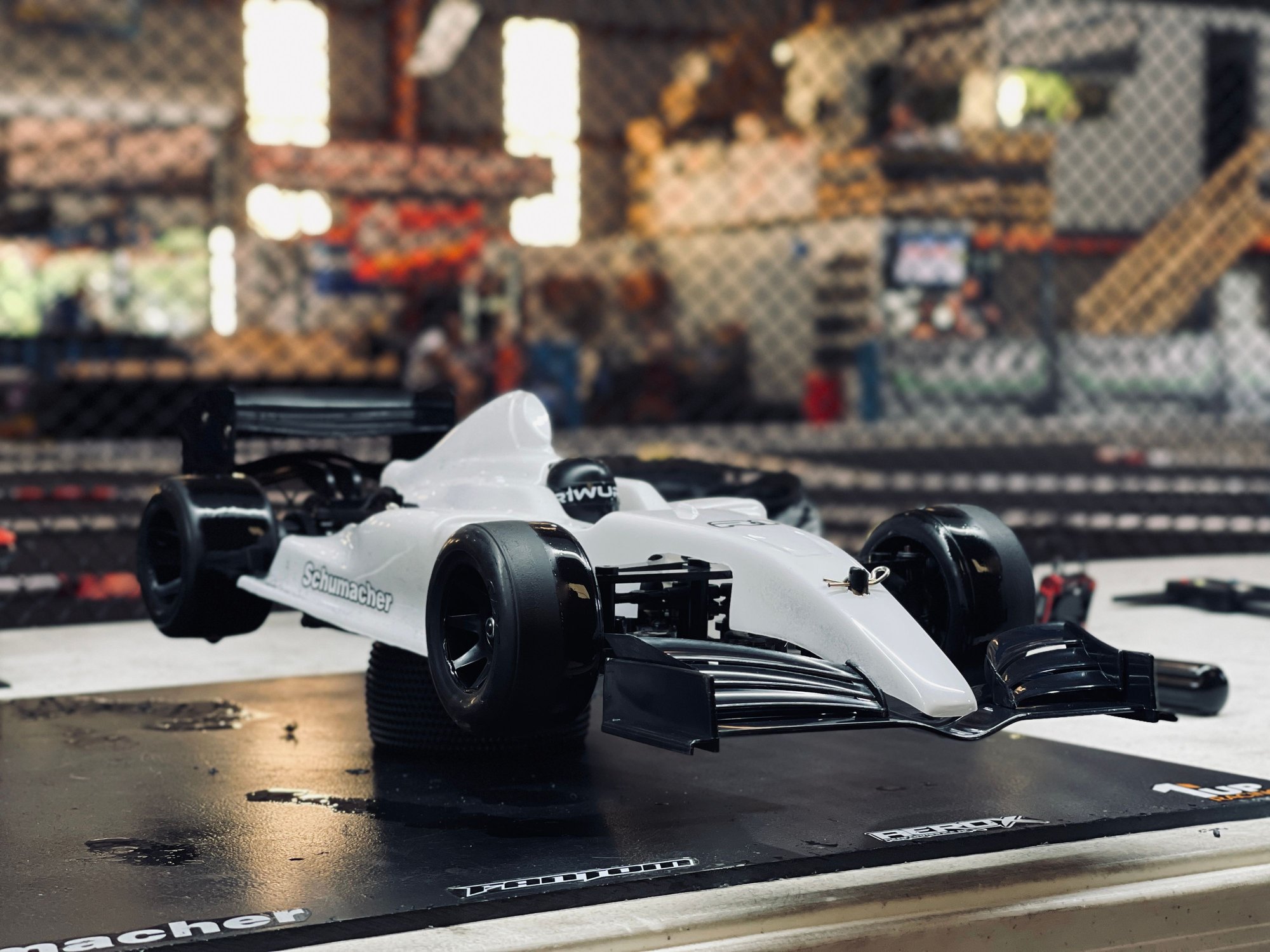

ChaodSan, what body is that in your pic?
The Teacher is offline
Old 08-25-2022, 09:57 AM
  #269
Join Date: Jan 2018
Posts: 282
Its an older protoform one F1-Fifteen or Fourteen I think. It does not fit in any way I wouldn't get one. Its been cut so much and spread out just to look like it fits but it doesnt.
