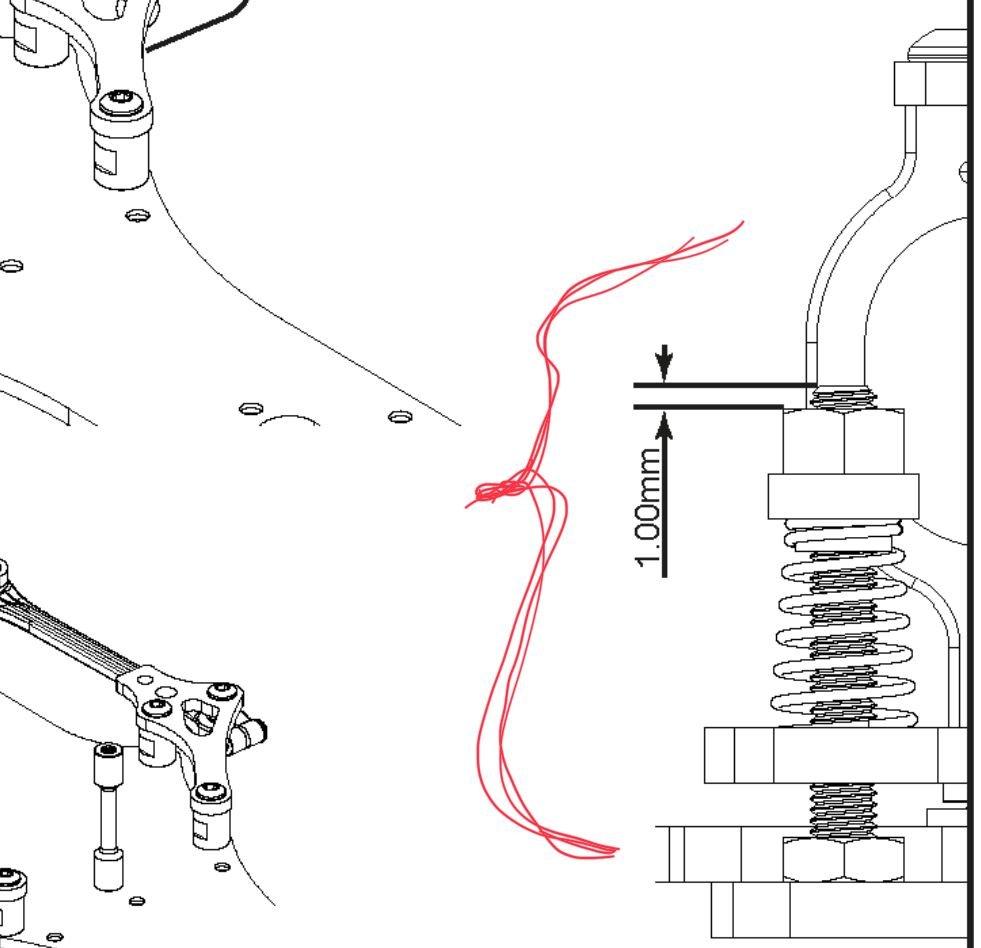

Default Rear Ride Height
How do I set the rear ride height of the Icon F1? I tightened this nut down a bit but I don’t think that’s right. Some threads talk about spacers, which I can find them for the front but does it equally effect the rear as well? Lost on setup here but love driving this!!
You are supposed to use that nut to set the angle of the pod. Rear ride height is adjusted using the eccentric axle bearing holders. Basically there are several pairs of the part the rear axle bearings press into. Each pair has the bearing in a different place, which changes the ride height.

Dang I overlooked that! Thank you for pointing me in the direction.
