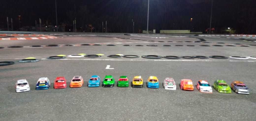

For us here in Brunei, we use the 8,000 and 10,000mah batteries for endurance races. It allows us to run EP races for hours on end and extends racing possibilities.
No longer will a crash or spin put you out of your final, you have a whole hour to make up positions and fight your way back to the top. We also have to deal with mechanical issues, poor battery management issues, as well as tyre and driver changes. We run 13.5 turn stock for these races and alternate between 1/10 TC cars or M-chassis. An 8,000mah pack allows you to drive over an hour with our current set up.

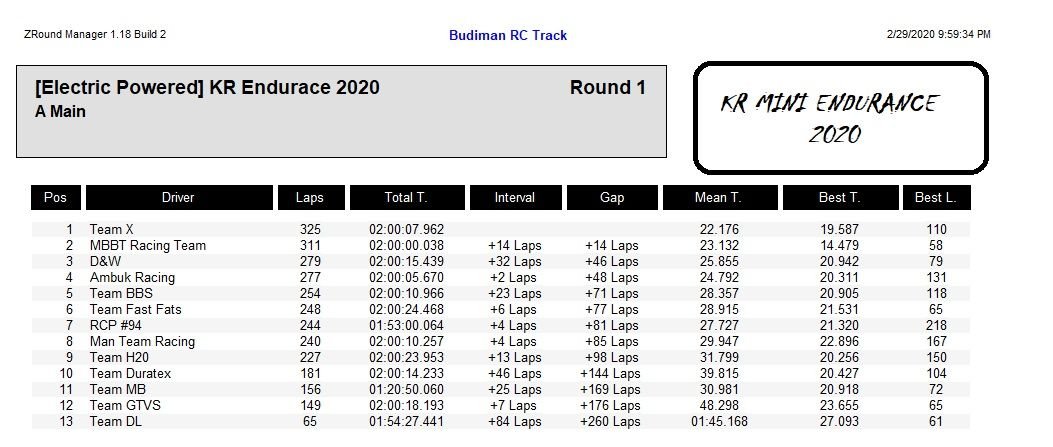

The last race we had was just last weekend. It was using the M-chassis and the race ran for two hours. We had two drivers for each team and at least one mandatory pitstop. Motor temps were easy to control as it was a night race and the winner clocked 300+ laps in the race. A lap was approximately 23 seconds. The nitro guys can no longer boast that nitro provides more run time.

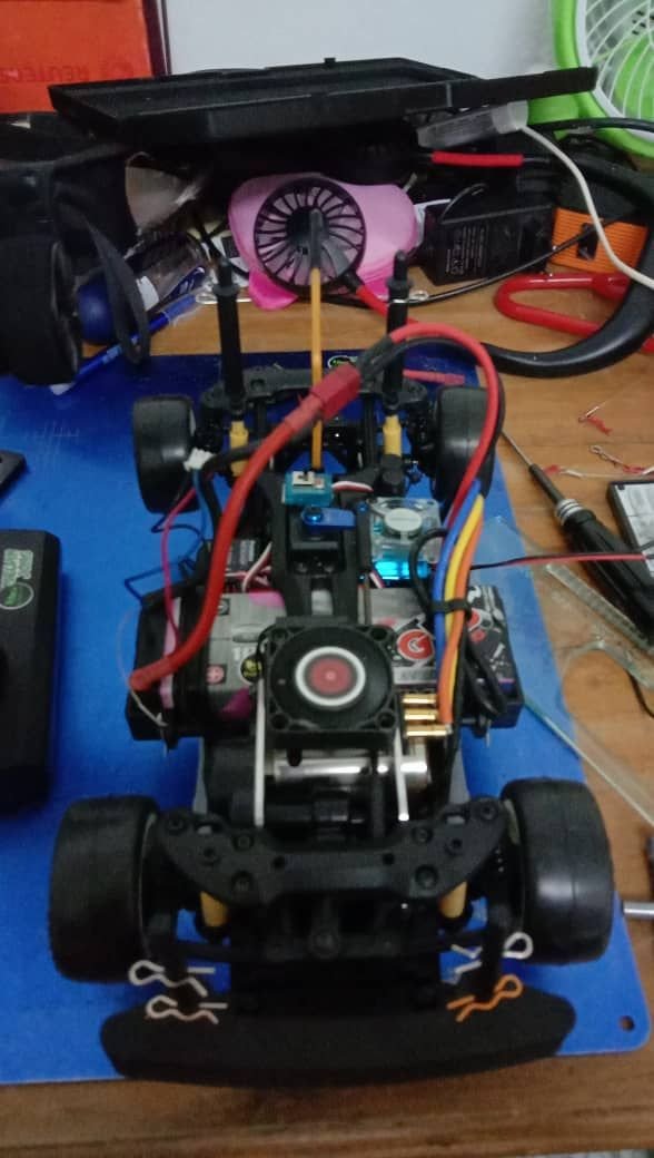

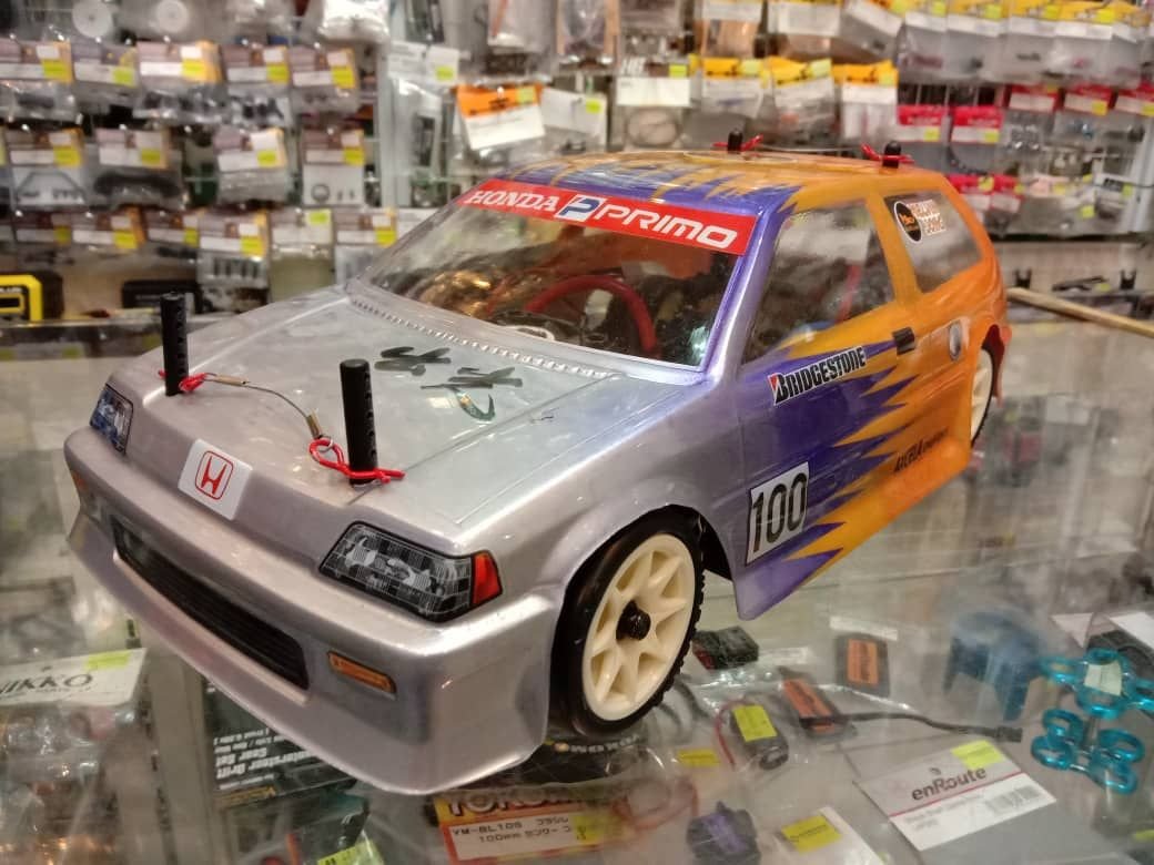

This is my setup running 8000mah GNB batteries. We pitted on the hour mark for our first stop and made a second pitstop after 40 minutes of running. Our seccond battery is a 6,400 Sunpadow. When we made our second pit stop, it still had not reach our ESC cutoff of 3.4volts.

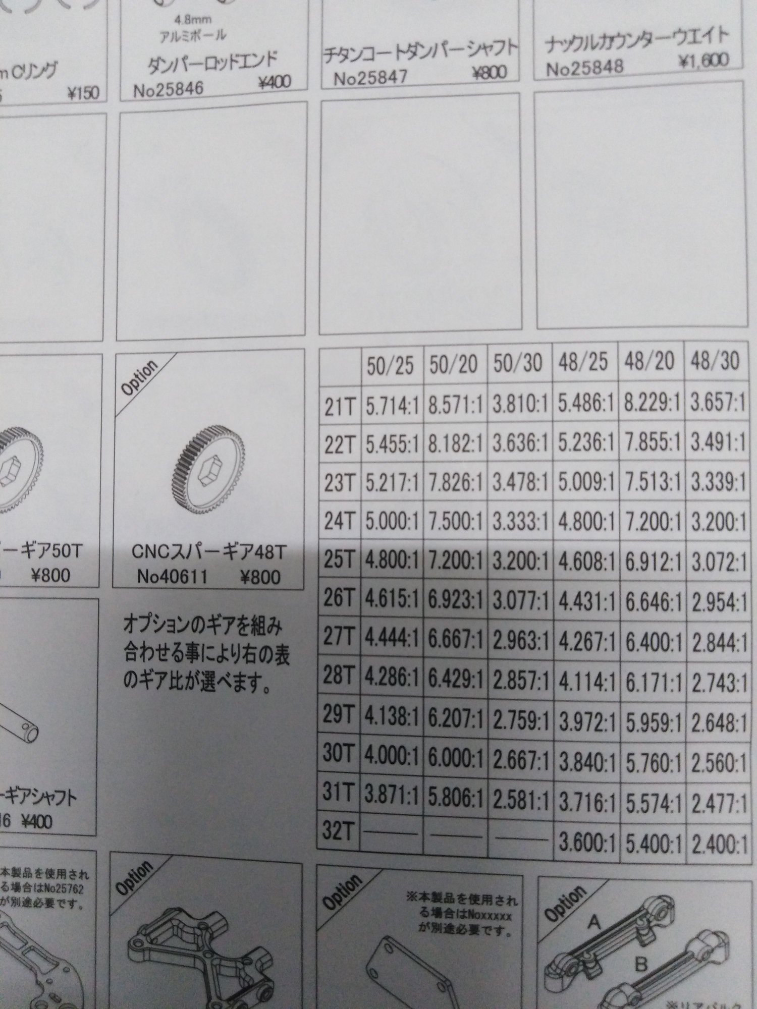

Originally Posted by gigaplex View Post
How did you gear the m-chassis at 3.8? The Tamiya minis are around 5.8.
Most of us run the ABC Gambados/Grid here and it allows for some pretty aggressive gearing. We also have a few Sakuras and they are just as fast which suggest similar fdrs.
Here is the gearing chart for the Gambado.
