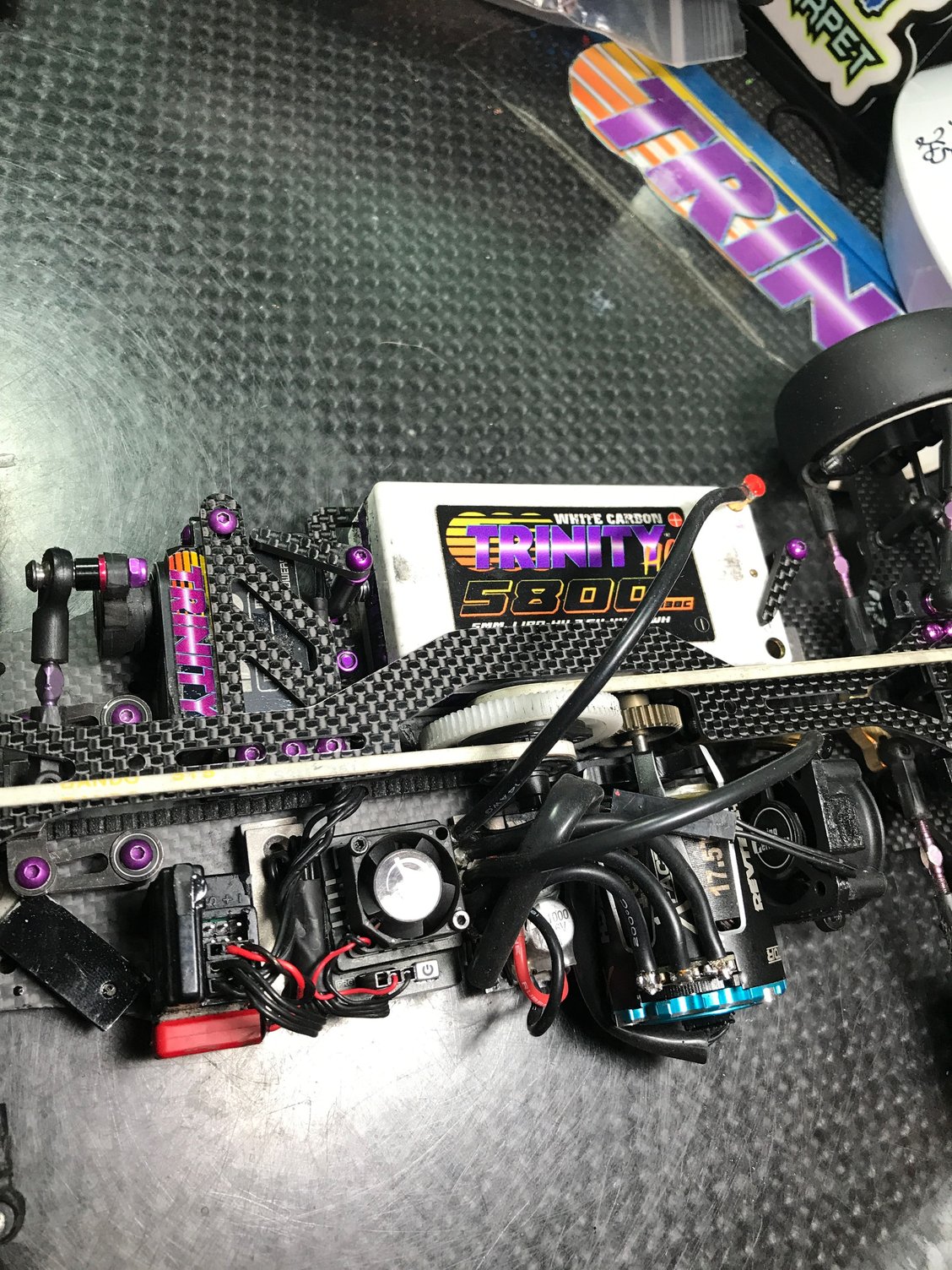

I run shorty lipos in my 3racing Sakura advance S. Came with the extra holes in the chassis to do it. Even if a chassis didn't have the holes, wouldn't be too difficult to drill them on a press.

if you flip the servo to the right and the shorty behind like my car there is no need to add the weight plates my car is perfectly balanced front to rear and left to right

I think there might be something to be said about the environment you're running the packs. On a big outdoor track, voltage maintenance is more critical, you're up at high rpm, where every tenth of a volt is gonna help you overcome stator inductance. Indoor, tight carpet? The short straights will make voltage drop matter less, as you can just crank the timing or gear down a little.. you're just spinning those tires anyway.
Speaking of small batteries, I run a super shorty in my FF03 seeking low weight. Since a run in USGT uses like.. 1200-1400mah, and the super shorty is 2650mah.. seemed like a sane choice to me.
I kept it in using VHB under the battery, and a bit of duct tape over the battery.
