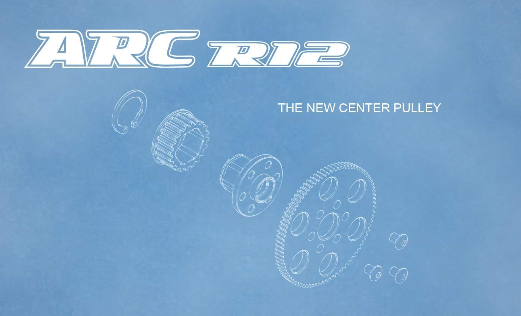

Update: All new center (20T) pulley design for the R12 allows for both front/rear drive belts on a single pulley. This helps with centralizing the drivetrain as well. With the pulley made of a composite material, this insures minimal friction and less rotating mass. The new design makes for an easy spur replacement without removing the layshaft pulley.

Tamiya 415 had that center pulley design back in the day with both the belts on the same pulley

That lock ring...needs to go....those things are horrible.

Mechanically valid solution, as you are not changing pulleys very often... The hexagon is more bothering me. It is not a very precise assembly and you can have problems when you brake hard...

The Xpress XQ1 mid pulley is a more robust arrangement than this one.
We had an absolute rule where I worked for 38 years, no lock/snap rings on a rotating part.

Can we change the snap ring to e-clip?

The E-Rings are simple and easy to install, so I can see why some people aren't too thrilled going to the snap ring. Personally, I've only had 1 E-Ring fail me over the years, but was from my own ignorance compromising the integrity. Honestly the only advantage to the E-Ring, they are easier to remove and install during maintenance.
The snap ring will certainly hold more load over the E-Ring, in theory as the E-Ring holds less contact area. Snap ring will be stronger in thrust, also have a lower profile. When installing the snap ring, you just need to be more careful it's not damaged by opening too much during installation, or removal.
Nothing wrong changing to the snap ring guys, this will only improve the strength of the center transmission.

Hex shafts are typically used in industrial power transmission applications, especially in heavy machinery. This will hold up just fine with the new application and will have very little compromise, if any under accelerating and braking. If your braking that hard, the belts would skip, or round a spur gear before there was any compromise on the hex style layshaft pulley.
