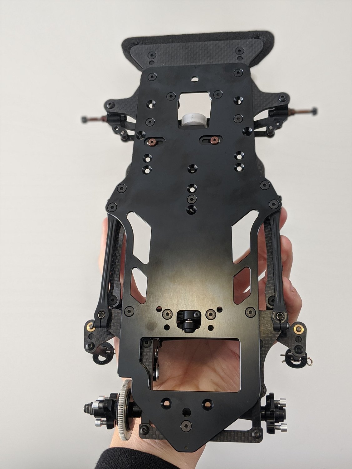

What a stunning bit of kit, went together amazing!
Just a few niggly jobs remaining, cut the body posts, balance complete electrical set up and paint a new shell

Eclipse 3 #1 ready to hit the track Tommorrow night, #2 nearly complete. Both identical other than #2 will be set up with a spool

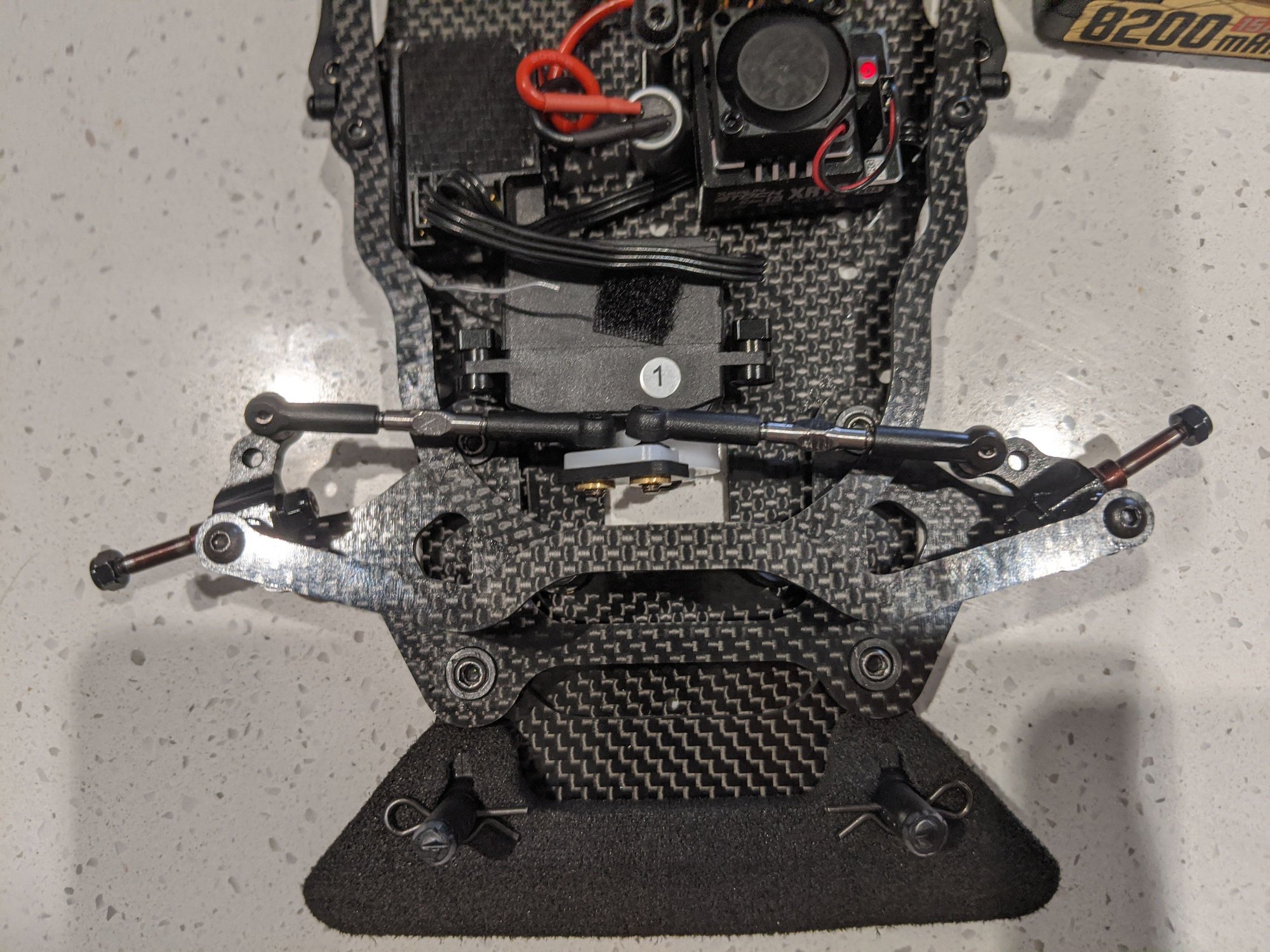

Hi guys.
just wondering if anyone else has encounted a similar probably with the Ackerman with servos other than the Sanwa SRG. I'm running Futaba BLS671s I'm both cars
I'm having an issue where my full lock at 26° steering inside wheel my outside wheel is only 13° manual suggest that it should be around 14° with the same toe of .75 on kit servo shimming
*Solved Further information for those not running Sanwa SRG*
My futaba was 2.3mm difference in demensions to the sanwa reccomended. So I've since removed the kit 2mm servo shims and that has brought me closer inline to the kit specs
