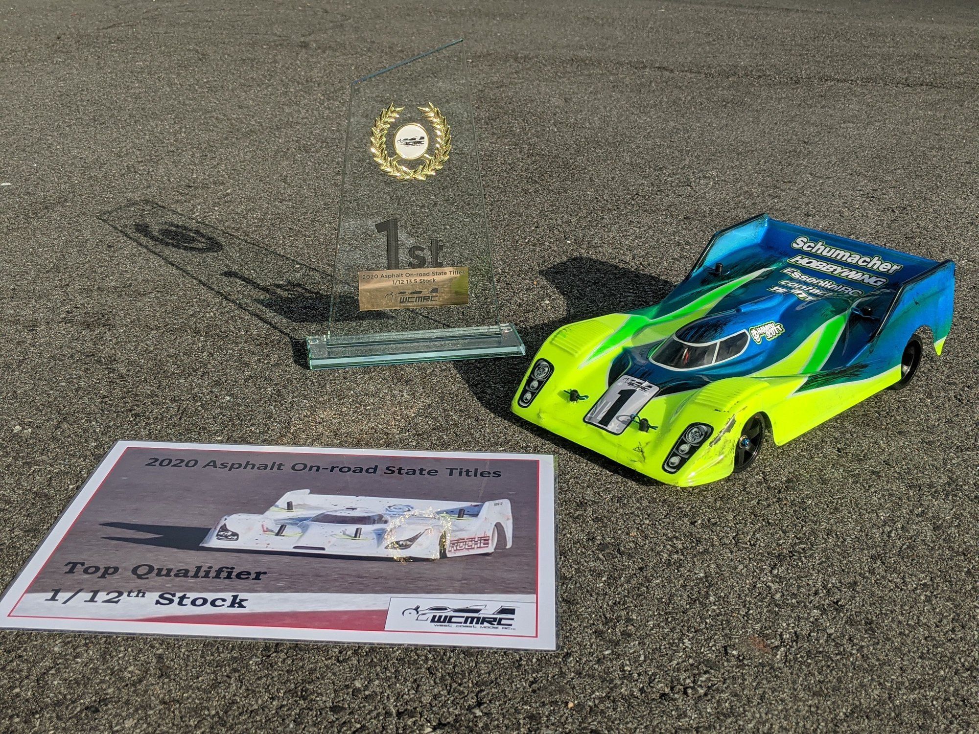

Eclipse 3 on Ashphalt this weekend, not normally something that interests me generally. But I had a ball. And the car was excellent all weekend . Bit of a difference to my open Pro10 and 1/8 but still had a blast
TQ and win in 1/12 stock at WA state titles
