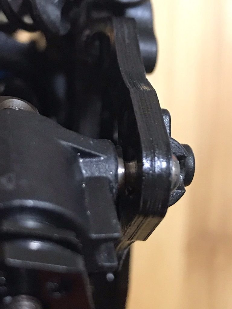

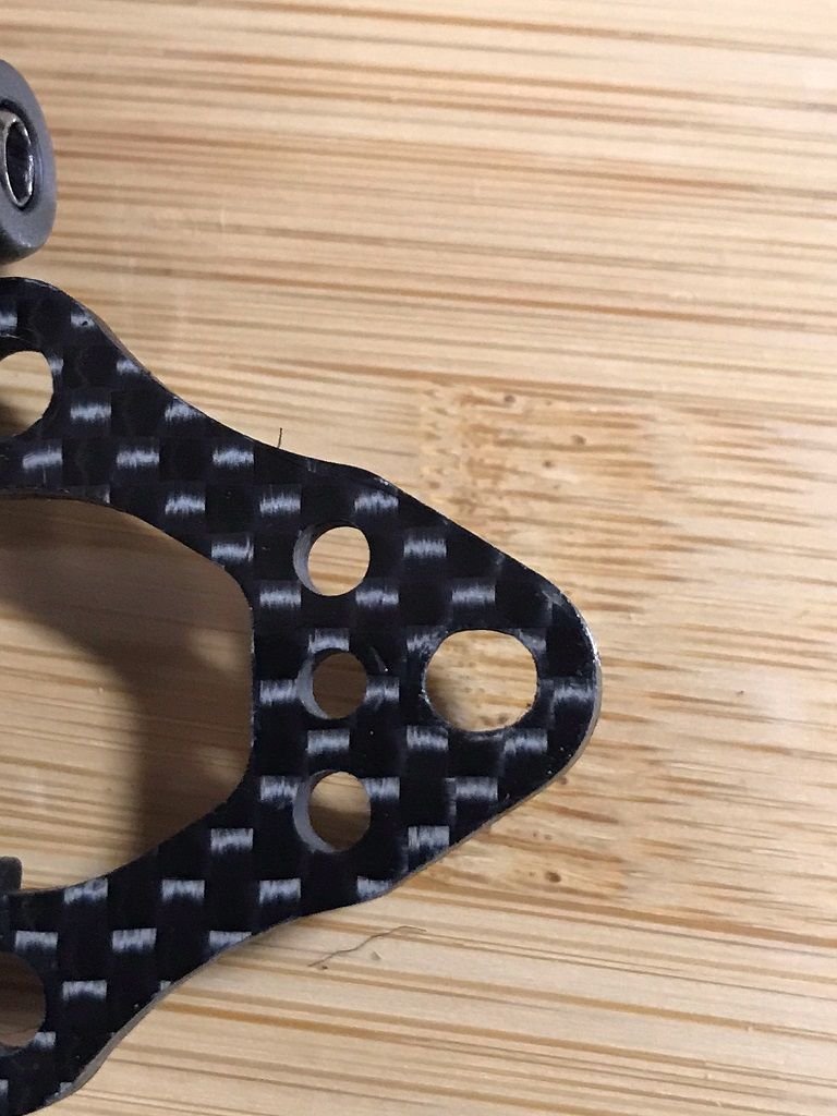

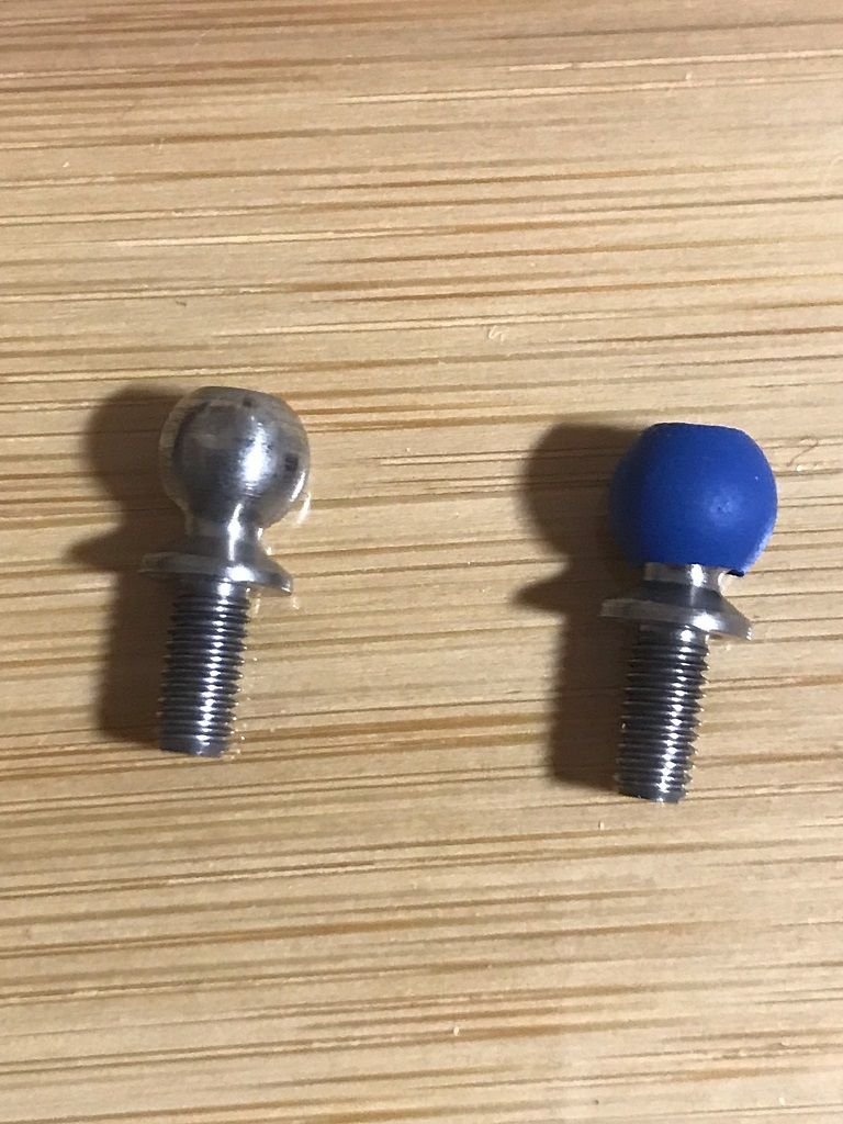

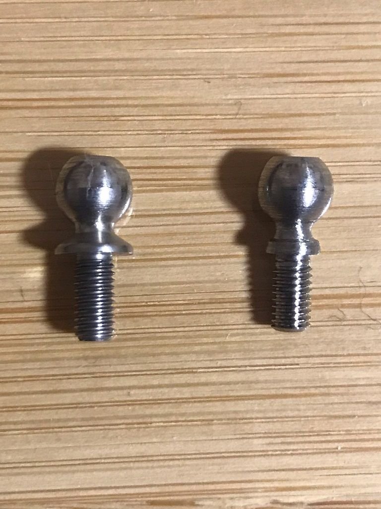

For those that are not going to the wishbone conversion this may help you. I have always disliked how the lower pivot balls simply thread into the plastic knuckle with nothing to tighten up to. I have had them wiggle loose over a few runs and tapping a board with a wheel knocks them out of position very easy and its enough to effect the camber. I came up with a cheap solution to help combat this issue. Since installing this I have not had any more of these issues. You will need 5.5mm short ballstuds from Tekno part #6206, a dremel with heavy duty cutting wheel, cordless drill, small round file and some heat shrink. Safety glasses recommended. What we are going to do is grind the shoulder down on the new ballstuds small enough to pass through the hole in the carbon arm but with enough of a shoulder to rest against the knuckle and allow it to be tightened up.
Slip a piece of heat shrink over the ball to protect it in case the cutting wheel jumps and nicks the ball surface.
Heat shrink covering the ball for protection
Chuck up the ballstud in the drill and spin it at low RPM. Use the dremel with cutting wheel to grind down the shoulder of the ball to be 4mm. Chamfer the shaft of the ballstud from the ball to the shoulder a little as well for clearance in the arm. Also trim the thread length down to 5mm or it will poke up in the knuckle and may touch the axle.
Use the round file to very slightly open the hole in arm just enough for the shoulder of the ball stud to pass through.
Bolt it all back together and have a more durable car.
qcrc likes this.

i just put a e-clip on the stud and was able to tighten it to the hub never had an issue with the ball stud getting loose took about 2 minutes to do the whole car at a cost of .08 cents for 4 eclips

There should also be a small plastic tool provided with the car to set the gap between the hub and the arm (hub carrier setting tool - MI7 Item No. U7740). You can then just tighten it against the tool.
