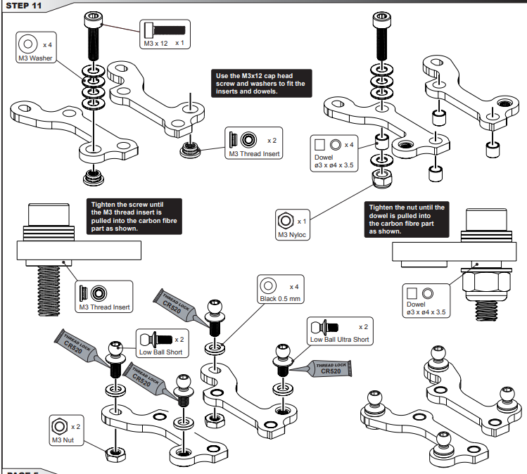

Those upper arms, EESH, I am skeptical about the durability. We used to have tons of issues with ours. You were either going to break/bend the turnbuckle, the upper arm or the carbon mount, and if not, you will likely have a car out of alignment after every tap. We tried most everything with the Original Gizmo upper arms (which these are almost identical to), to make them last. I do see the thread engagement being pretty deep, so that should help, but I don't think that will remediate all of it. That is a lot of stress going through that single 3mm turnbuckle and upper arm.
Good news is that it looks like it will be fairly easy to replace the upper arm with Awesomatix Scissor links.

We tried that. Actually have some just like those on my Stock Genesis to lose some weight up top.
You can make the upper arm mount stronger, then the issue just gets moved to the upper arm. A single perpendicular turnbuckle going into the outer hub is inadequate, much more so with a 3mm turnbuckle. There is a lot of force being focused on that area when you have a side hit or clip a sweeper. We used 8th scale parts and 4mm turnbuckles, and it still gave issues bending plastic parts and aluminum parts (even snapped hardened steel 4mm turnbuckles.

Hmm, itís not immediately apparent as to how caster changes would be made (optional carbon standoffs for the upper A-arms, I suppose), but an interesting design inspired by what some 12th scale chassis are doing indeed. Providing both lower chassisí in the first run is certainly interesting incentive to purchase early. I recall that Yokomo similarly included quite a few option parts in the BD-9 when they launched it as well.
