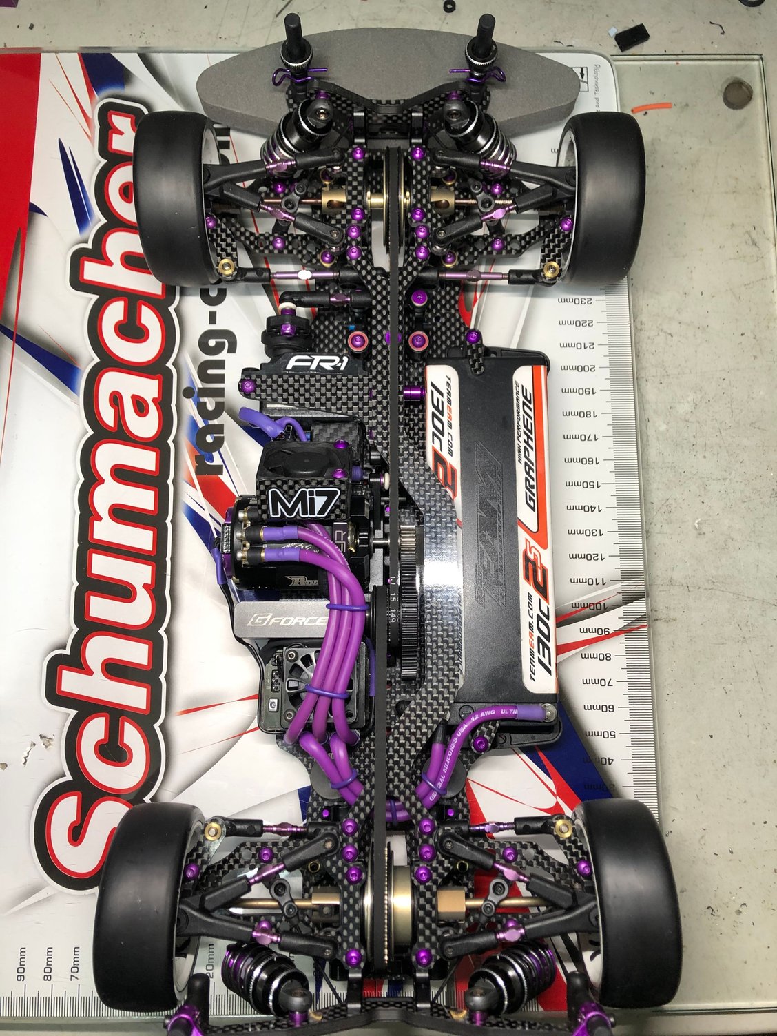

Originally Posted by Larrysraceprep View Post
The top deck pitch control is a necessity also 1/2 turn clockwise on the ball studs for the
Note the angle the pitch control rod do not lower it with shims “do not make it level”it will create too much chassis flex behind the motor mount
rear steering hubs to lower the role center
Did you drill the top deck and counter sink it yourself?
yes just go as far forward as you can without having clearance issues with the steering rack and it will be off-center I just put mine directly under the front drive belt

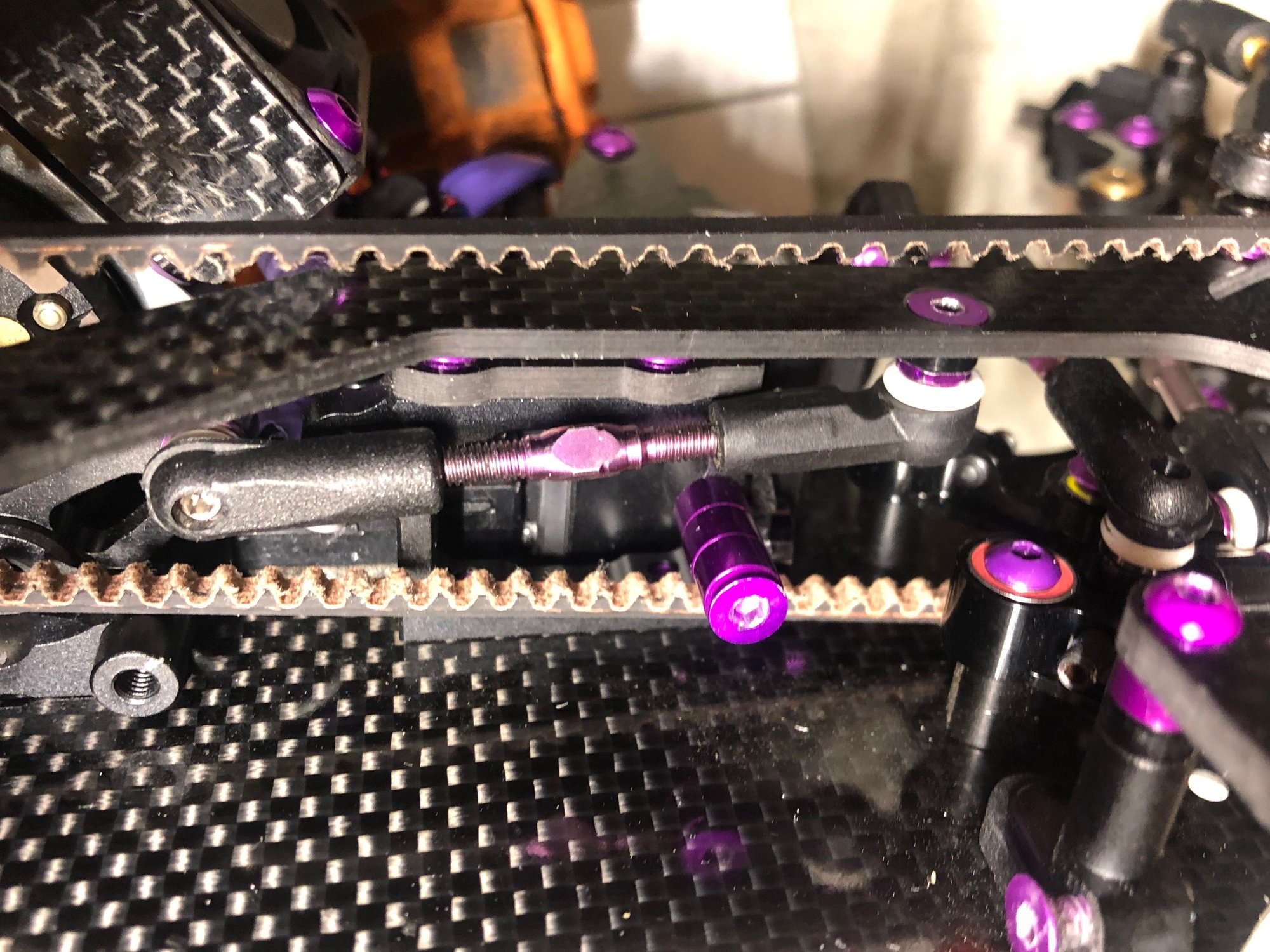

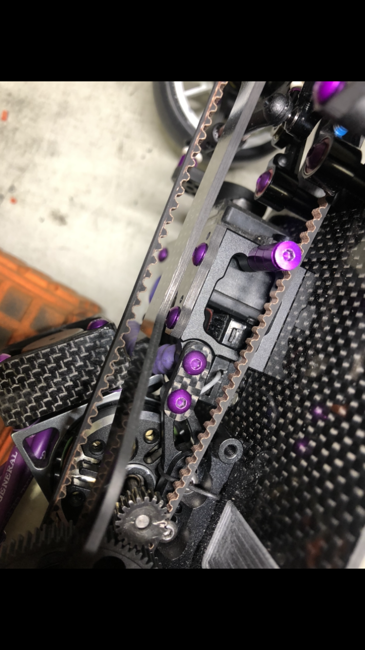

This was another option (sorry I know itís ugly I made it at the track in just a few minutes) I only got to test once with .5 and 3mm carbon and it worked OK but not as good as the turnbuckle did it will probably be good for carpet,
Plus with the turnbuckle you can run your belts a little bit looser than normal because it removes the bulkhead flex front to rear but not side to side so the front belt doesnít skip on hard braking

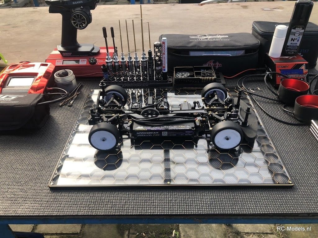

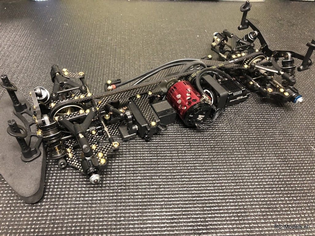

My MI7 from indoor 17.5T to outdoor 4.5T. Because all the tracks are currently closed down it will be a while before i get to run it again.

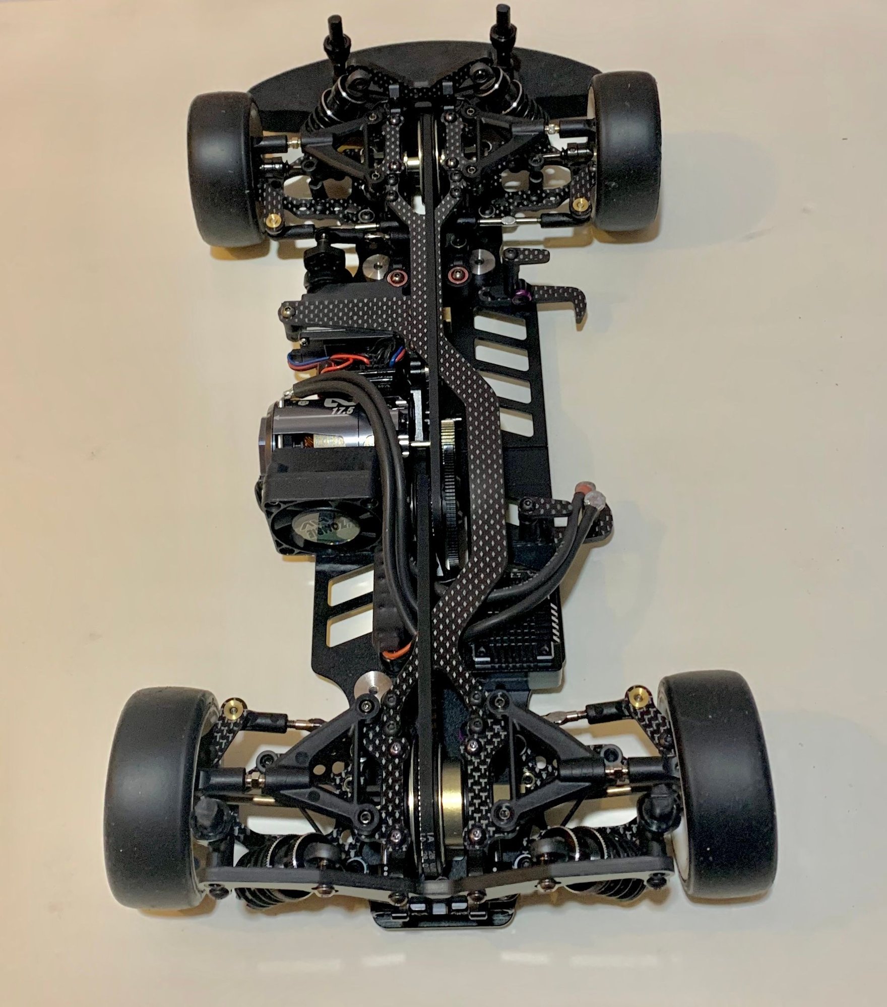

Default Shorty Mi7
Tried the ďshortyĒ configuration and went almost 2 tenths faster in the hero lap - but more impressively got 5 seconds faster in a 5 min run. Car felt more planted in the corner but would rotate as well - or better then the traditional battery. Left to right weight was very close with a 5600 mAh battery once I moved the esc. Car is right on legal weight and balances 50/50 R/L and 51/49 F/R

Why install the this V system instead of the Y system for turnbuckles?
Try to look for HotBodies turnbuckles if you want purple ones.
Airwave is offline
Old 04-21-2020, 08:34 AM
  #240
Larrysraceprep's Avatar
Join Date: May 2014
Location: Austin tx USA
Posts: 171
When I ran for Gizmo our first generation car had the same style arms as the mi7 the problem is if you ever hit anything Even In the slightest the car goes out of alignment ridiculously easy especially the castor and with the amx scissor arms you also get the opportunity to change wheelbase quickly and also add or reduce arm sweep or wheel base without affecting your caster adjustments
