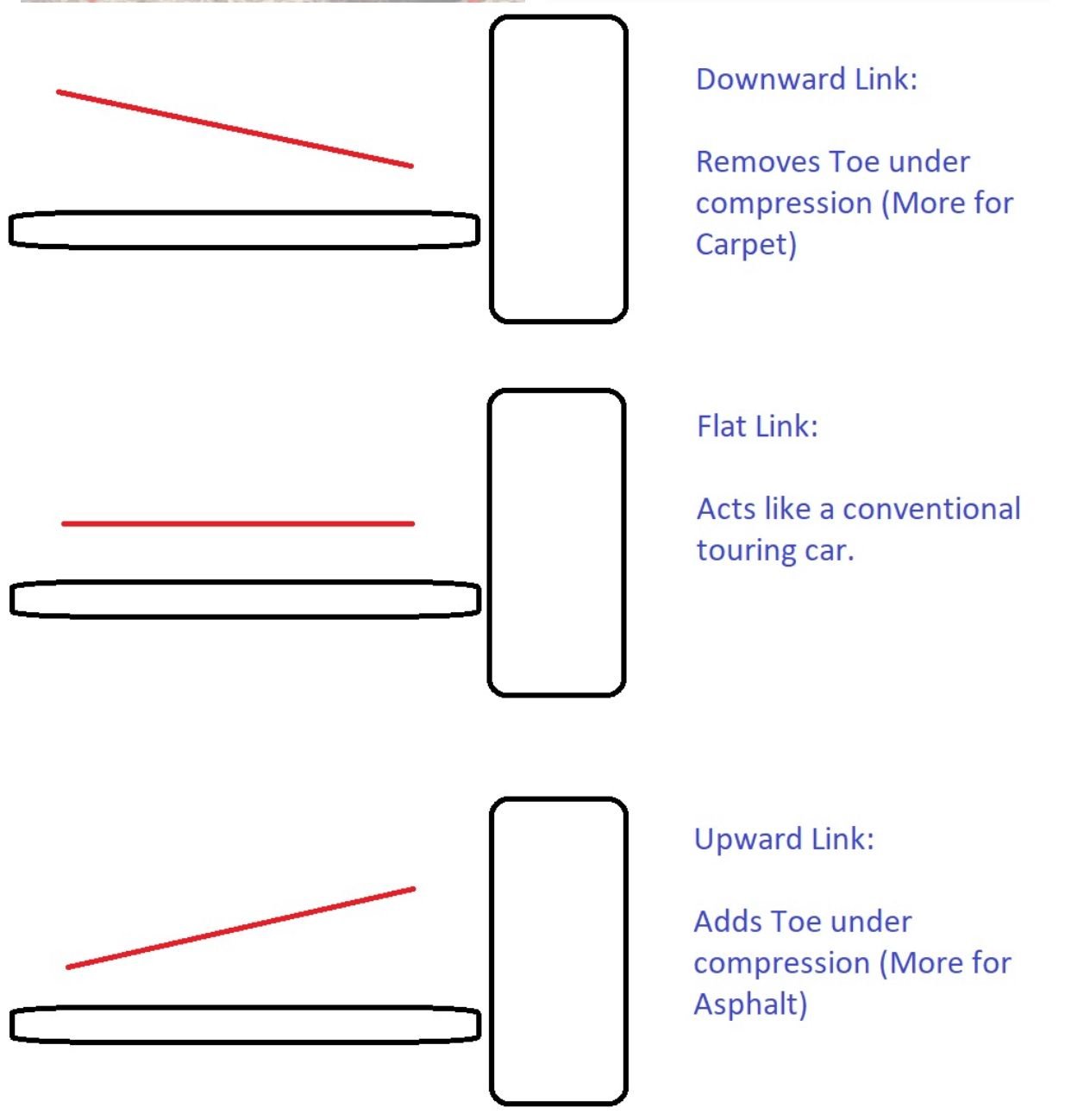

I like the picture explaining the ARS system. I like the added adjustment with it. I am a bit surprised that ARS system is not used with cars that offer that option. Perhaps it adds more complication to the car.

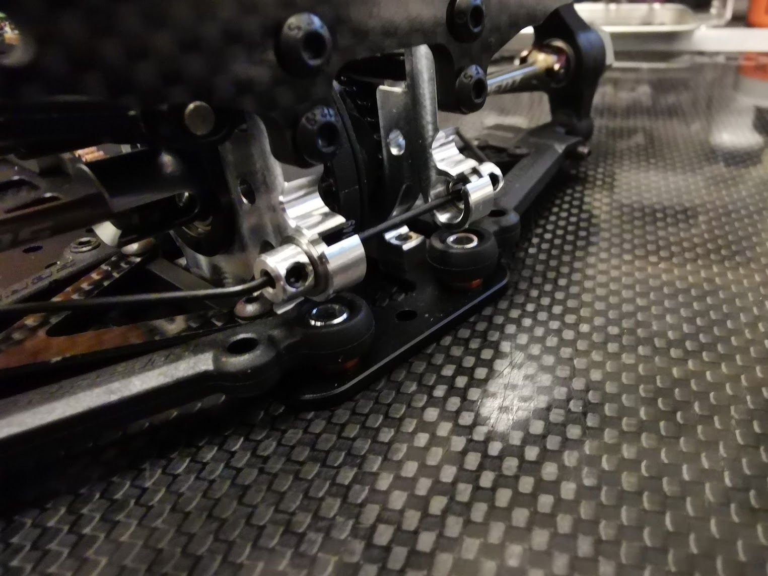

antiroll bars support just above the balls... Seriously... Balls have hexs to be screwed but you can't use them lol

They could have clearance cut the roll bar bearing mounts...

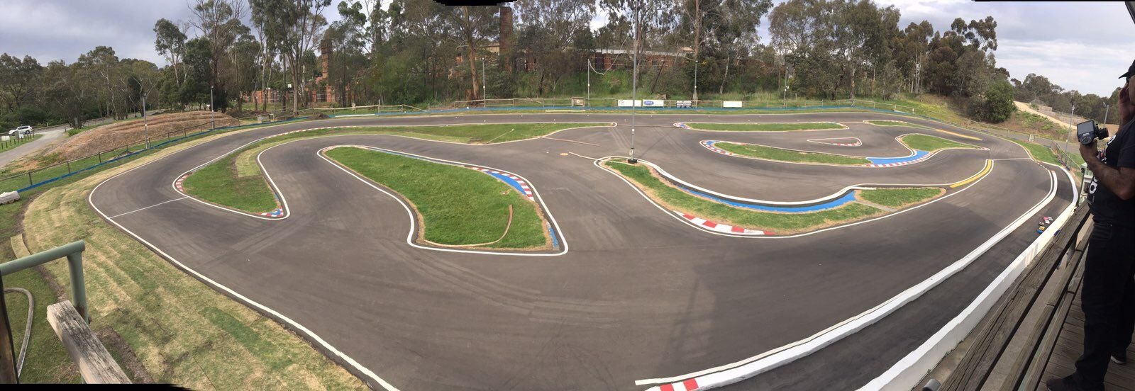

All cars running ars at my local track seem to have inconsistencies in the handling on the off camber corners. Well aware of setting droop and springs but could never get the 4x to be in a consistent window to compete. Flat tracks no worries. The track I race at is unique
Little Hampton South Australia 🇦🇺

The manual shows a tool that fits under the suspension arms to holds the balls during tightening. If that's the compromise needed for better geometry, then it's no big deal.
