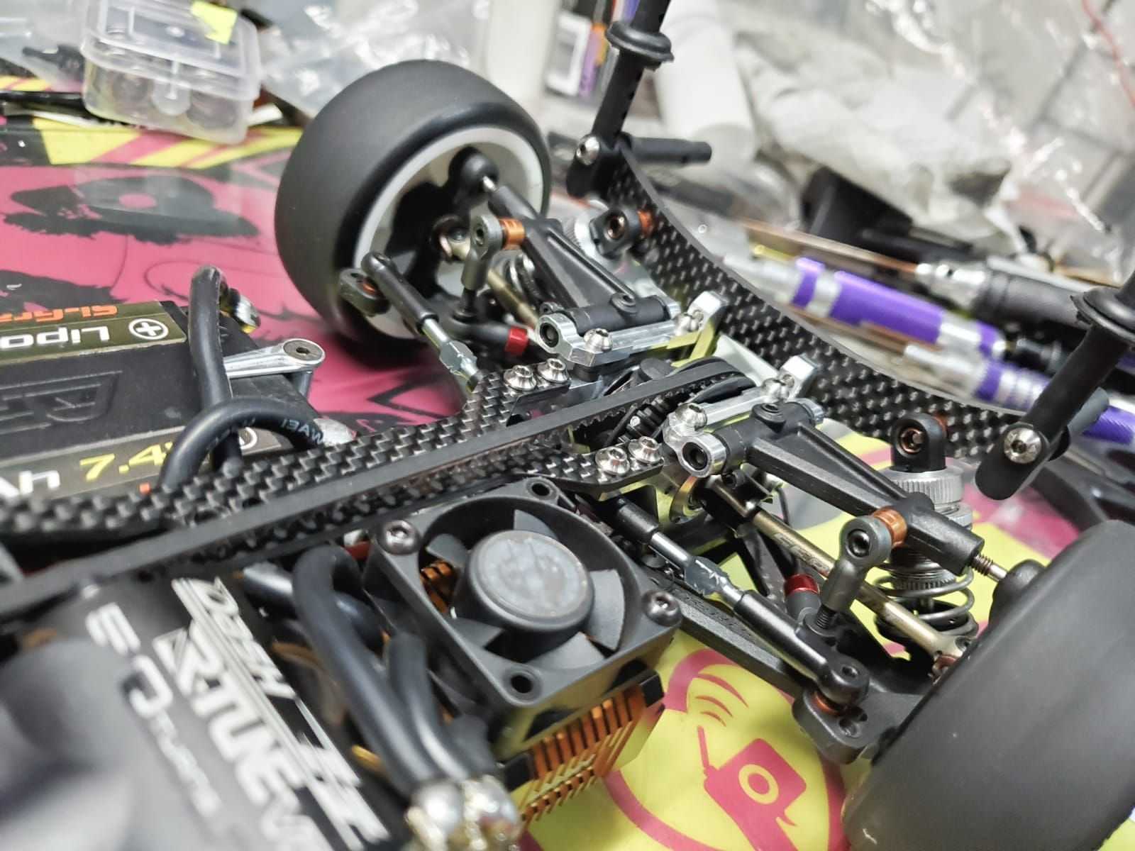

Phototype

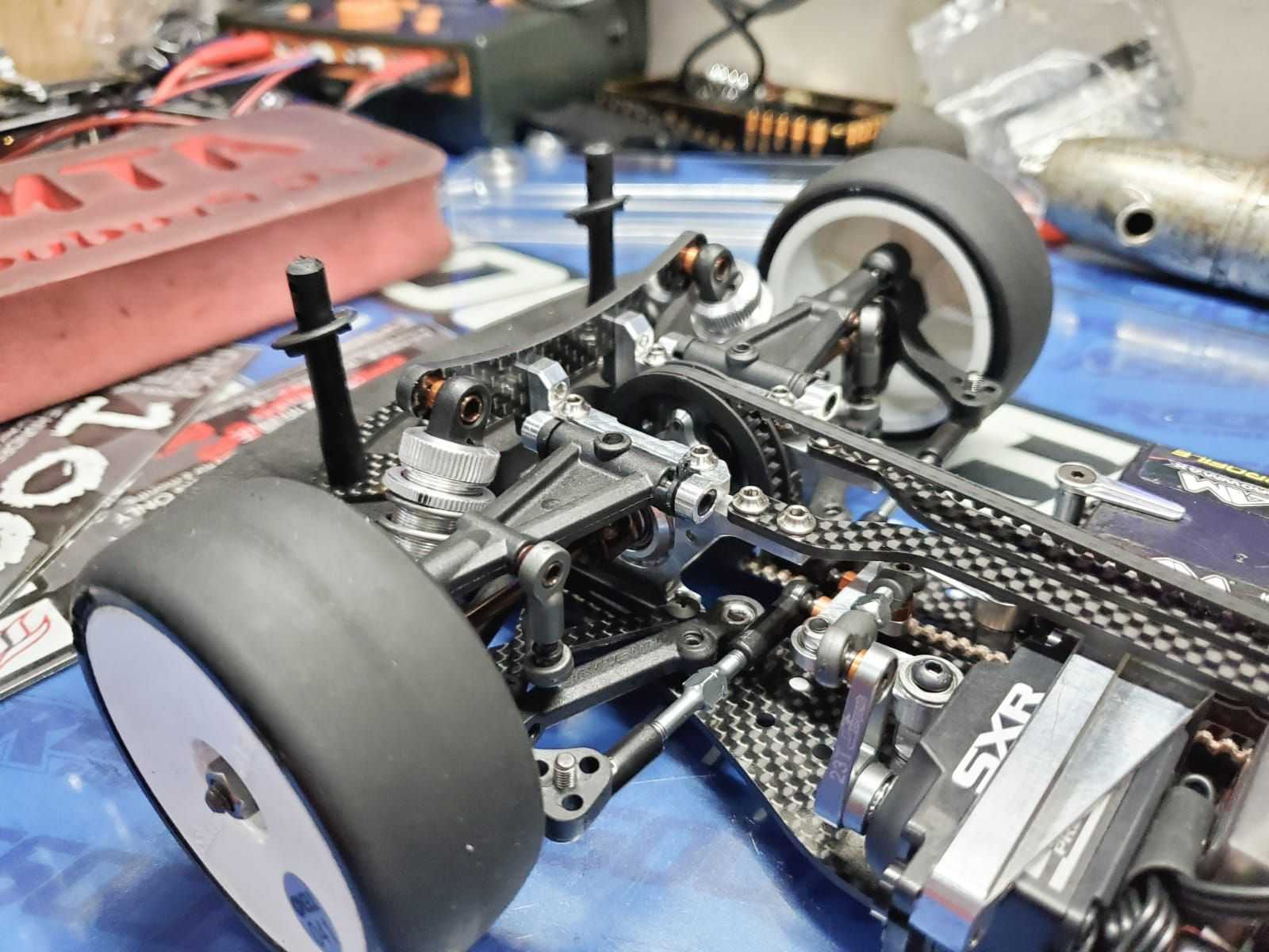

Rear

So, a 4x with motor more central and ordinary shocks...

Hmm, so looking at those pictures, it looks like theyíre still committed to the active toe rear end. Iím wondering if with the new car, they are reconsidering this as a viable option? It was my understanding from when I originally read up on the 4X that they relegated that configuration to a preference for Stock racing, and recommended the fixed toe configuration for Modified on the 4X Pro.
I'm sure that you can set it so that there is no rear toe change through suspension travel.
