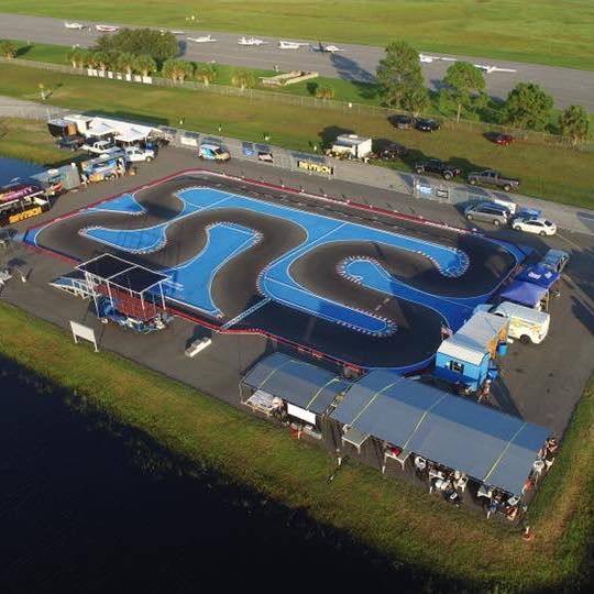

This is the next track I will be testing and refining my setup for the X20. I should know by Friday if I can attend the Valkaria RC Raceway Sunday.
The X20 has came a long ways for my testing in 17.5 blinky. I hope to have a solid base setup soon. I will be testing with a Gizmo guy. We have been sharing info on how the cars compare. I think they are pretty close. One has C hub and Serpent has pivot ball. Good R& D.

Wow, nice layout! Although I do have to say that the drivers’ stand is a little biased toward the left side of the track. I’m guessing that preference is going to lean toward the right side of that stand, hehe.
