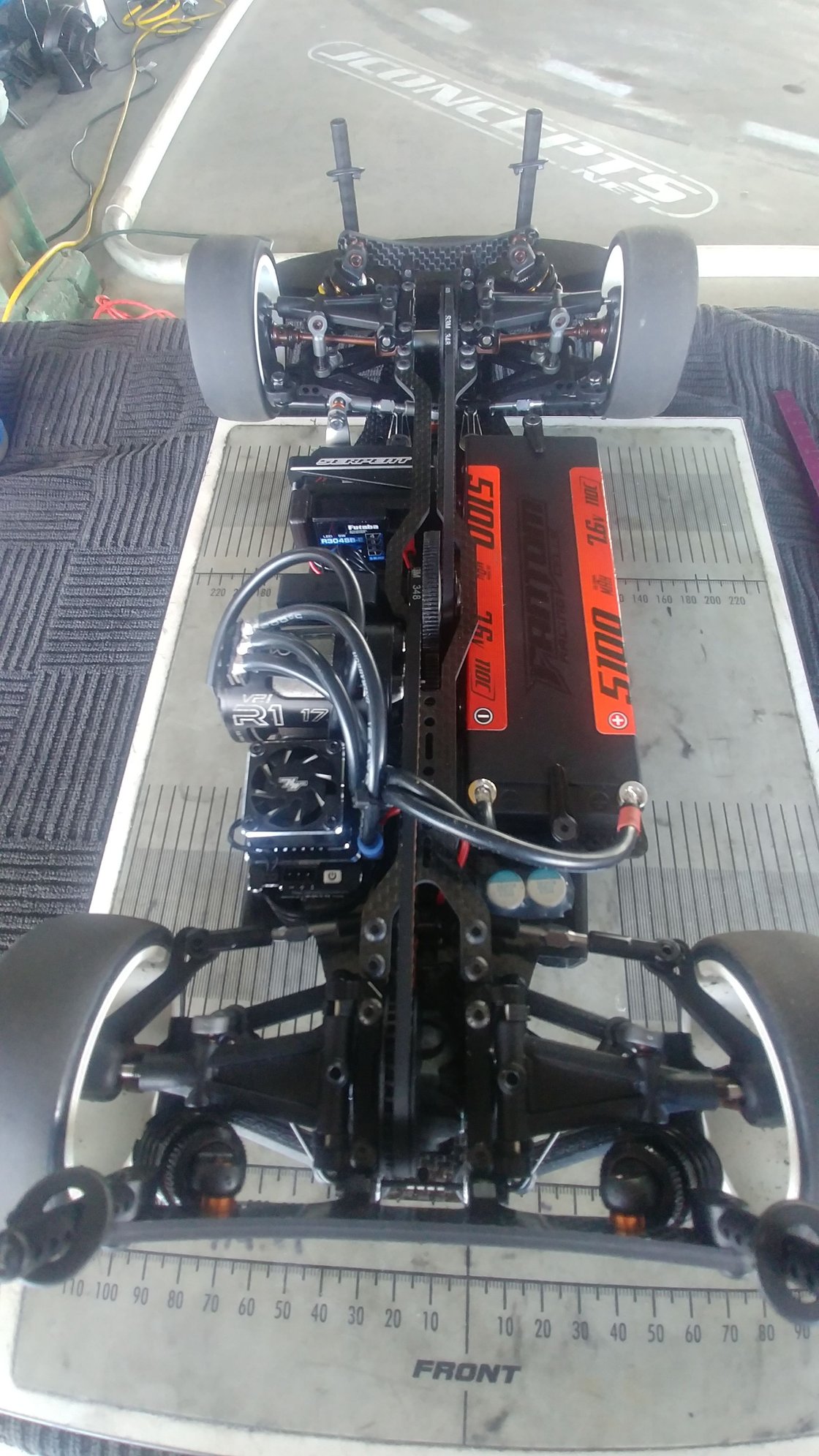

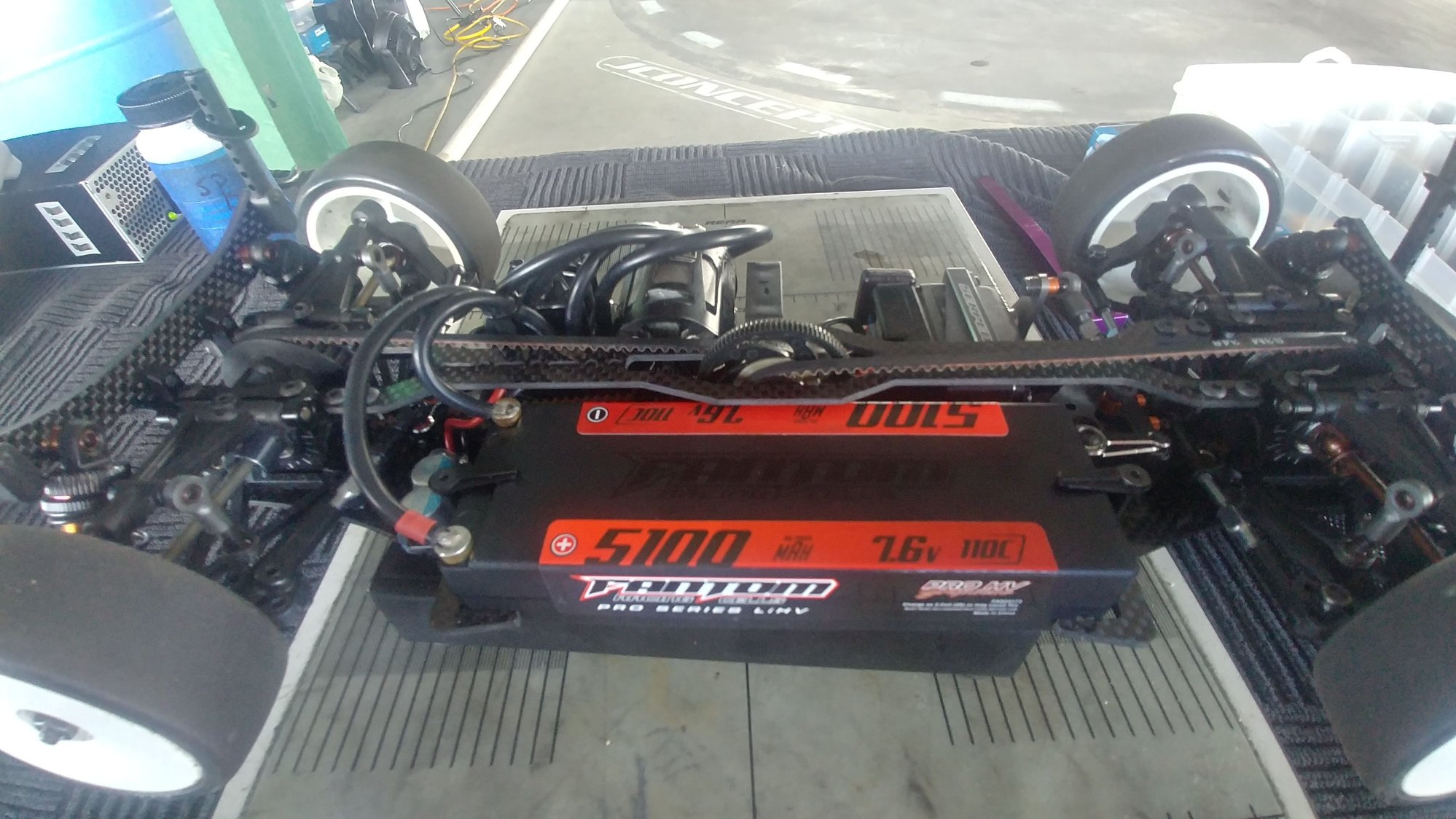

OK guys I got the first race in with the new Serpent Medius X20. (sorry for the poor photos. I have a bad lens on my camera phone)
I first want to post comment on the negative part of the car. The building of the car sucked! I got the box and it had NO manual booklet. So I had to use the download manual on the Serpent web site and if you look through it you will see no real setup to run. Some of the photos were not very clear when you are dealing with small parts. Also no support for a base setup on any of the sites I could find related to Serpent. With that said....
I went to the track with how the manual recommended and my final adjustments on my setup station which is a very must have with this car.
So the track is a covered concrete treated track and I am running 17.5 blinky with a Protoform Type S body. I never changed bodies so I wanted a base for my testing.
Once I got my radio adjustments for steering I made my first lap around the track. One thing that really grabbed my attention was how straight the car tracks. With standard tie rod cars I always felt the car would have a slight drift to one side with the play in the linkage. This car was dead straight! As I entered the corners I really like how smooth the car rotates around. The mid motor really is a smoother feel compared to my rear motor car. After a few laps I went back to the pits to find a setup. The manual build was not going to work as I suspected.
As I made changes throughout the day I really like how I could make a small change and instantly tell the effect on the track. For me that was a huge plus. The other awesome aspect with this car because of the pivot balls front and rear is huge range adjustments at your disposal with the box stock. I could change caster, rear toe with tie-rod links, I could change rear hub angle. With a C hub car and standard rear hub cars you have to buy those adjustments. This was awesome because I am kind of a cheapy and a bit of a lazy tuner. Meaning I would rather work with what I got rather than going through the trouble of buying a 3 degree hub and changing it only to find out I don't like the feel of it and stuck with a part I will never use.
This was a HUGE plus in my book. I can run a 3.5 degree front caster with a .5 degree rear hub angle if I want. This is precision tuning in my book and I love looking for the hot setup.
All day I searched for a setup and as I tested and tested I enjoyed the car steady improvement. I qualified 4th and managed to finish 2nd. I even had a pass for 1st spot but got spun out.
All in all I am very impressed with the results with the car.
A few key notes if you want to buy the Serpent X20
1: Keep your PC near by because you will need to download the manual and use to build.
2: The car does not come with any chassis braces which I think is a bit of a negative but worked fine without but I will be buying a couple because the car has a tone of flex.
3: Make sure you have a setup station and board. You will need a setup station with caster adjustments.
4: Perhaps soon some setups will be posted to give you a starting point.
I hope this helps!
Hey Brian, I know these are older pictures of your car, but I haven't seen anything posted that is newer from you where I can see the rear steering links, but by the look of the angle of those rods, I'd say you have the inner rear steer block mounted one hole off on your chassis. It should be towards the rear one hole, or so that if you use the rear optional stiffener , you have one screw hole to mount it to. If you have corrected it, please ignore.

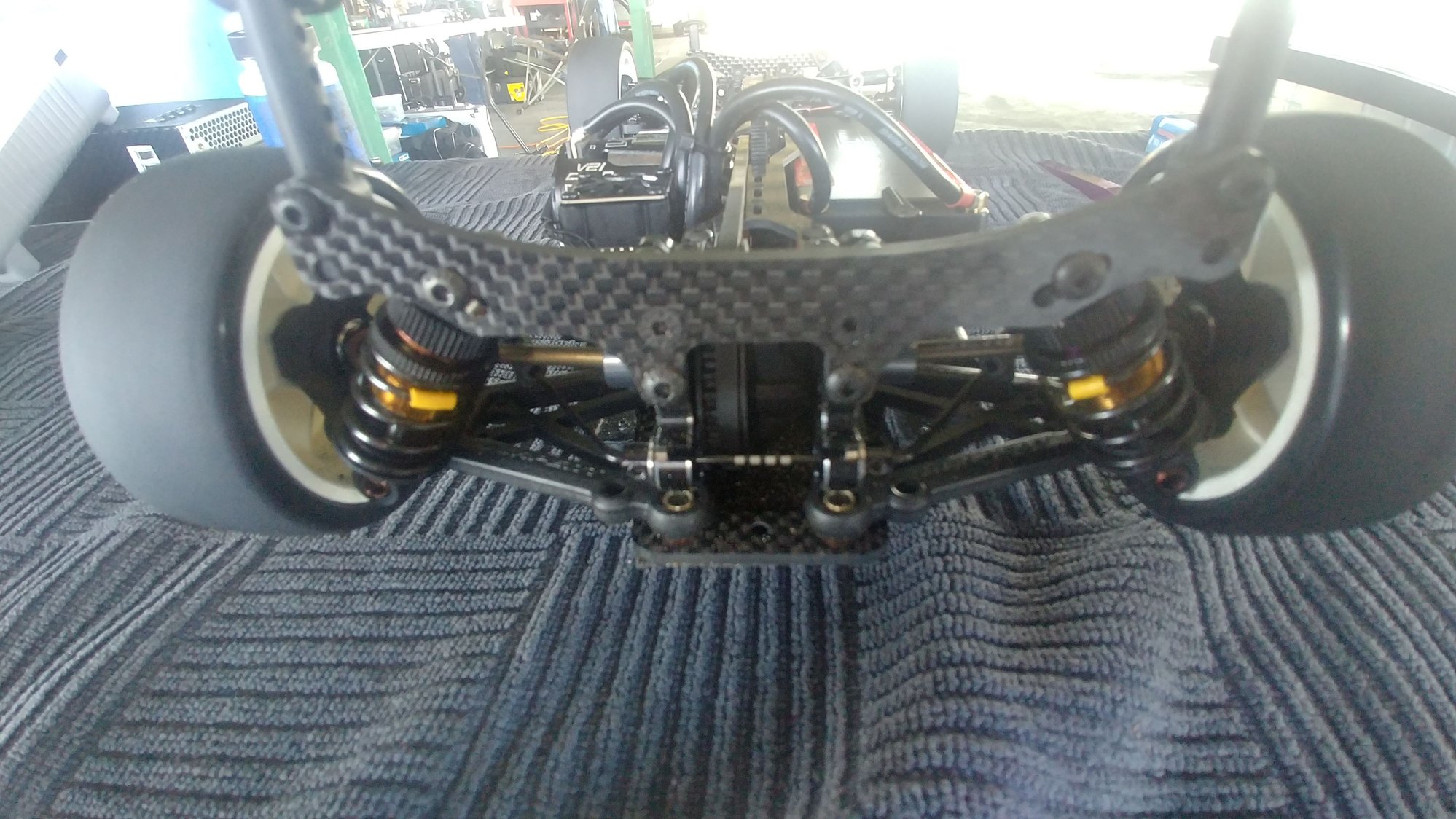

Originally Posted by dawgmeat View Post
My aluminum car IS stiffer than when I had the carbon chassis
Dawgmeat, looking at your pics I noticed your upper front arms are oriented the opposite way. Not sure what bearing that has on caster setting but it the opposite of all the other pics I've seen.
dawgmeat likes this.

[email protected] my life there are backward lol, probably running 2 degrees of caster, I change it tomorrow. Thanks for the heads up

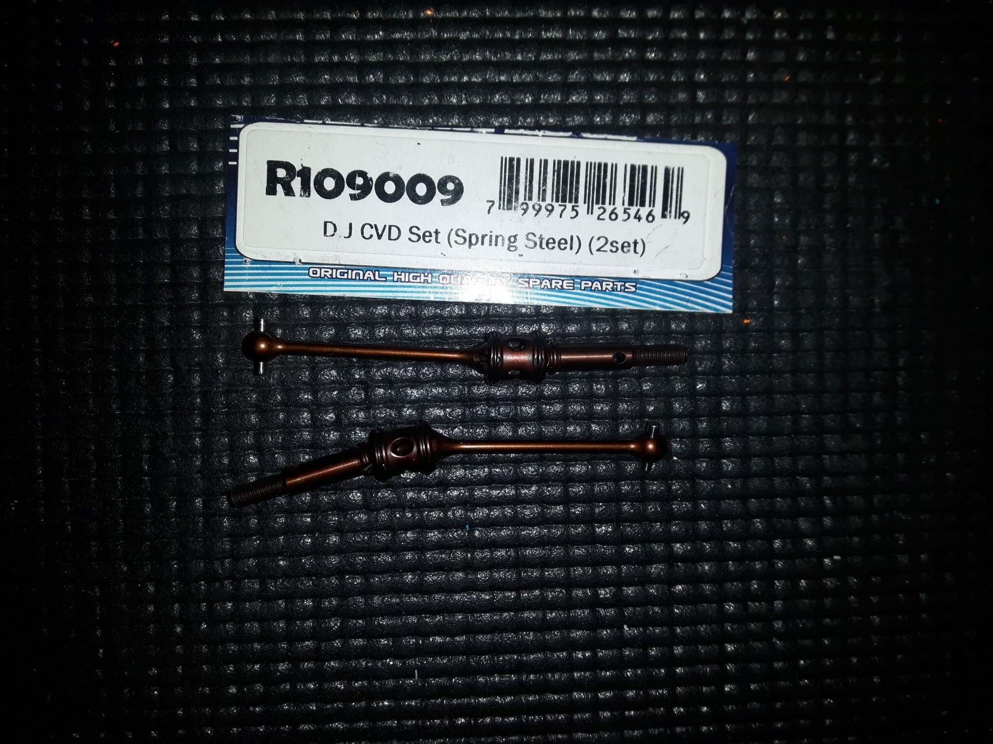

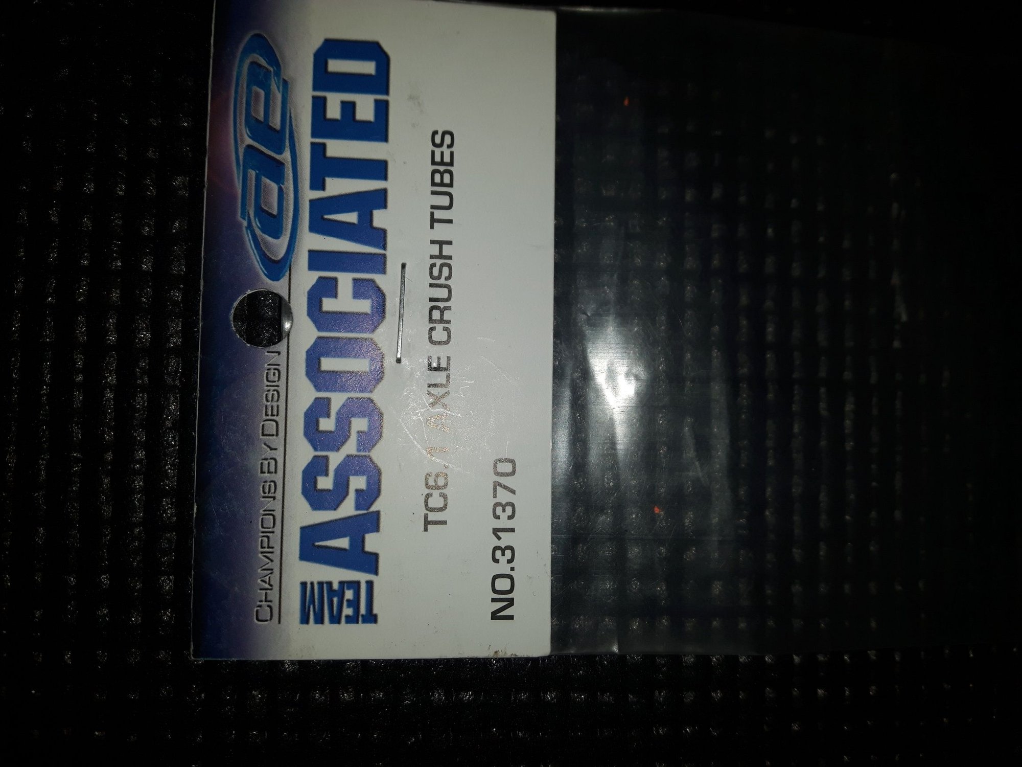

Here are a couple build tips.
If you find that your having DJC problems and you can't get Serpent replacements, these ARC units will work.
I like to run bearing crush sleeves in my cars, the AE ones will work, I used a 0.02mm shim as well as the crush in the front hubs, the rears require no shims.
