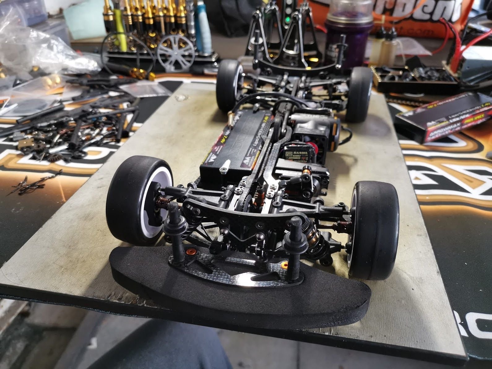

I agree, so made my own mounts for them. I made a front stiffiner and made the upright mounts for the rear X brace behind the motor. I will test them this Saturday and see if it will work. It for sure stiffined the chassis more.

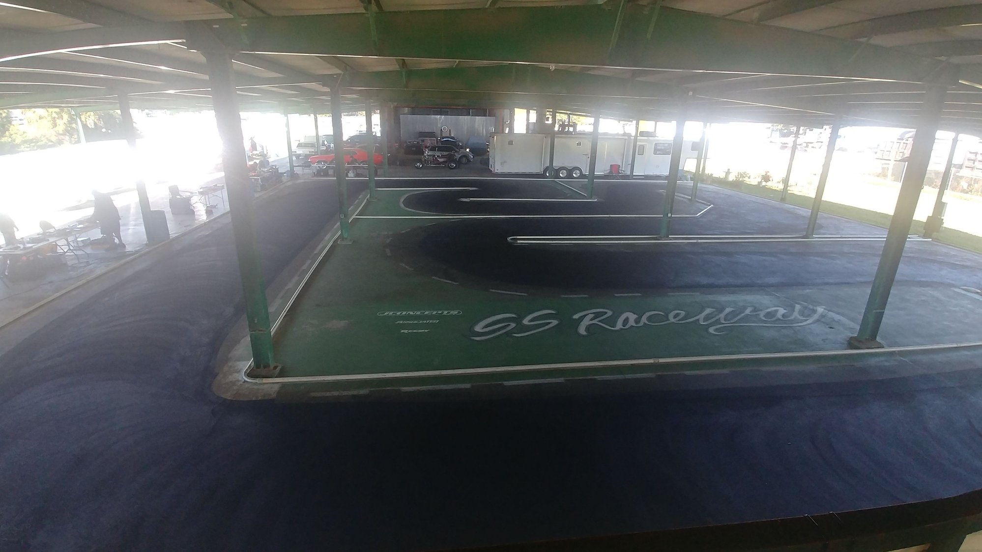

Race 4: Covered concrete tract.

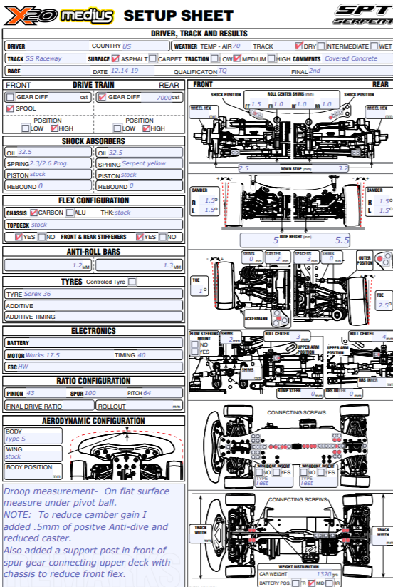

I tested chassis stiffeners and had great results. My thoughts at this point the box stock graphite chassis kit is to soft. I added the X brace behind the motor and I also added a post support in front of the spur gear. This seem to help stiffen the car and have a better feel for me. I was able to get the car to carry through the corner pretty good but I am still working on a lack of steering entering corners and I think the reason is around a problem I have found. The setup I was running has to much camber gain which caused the front inside tires to form a ring. They were new tires so I know it was the setup. I took a screen shot of the setup I was running and I will also attach a screen shot of the setup I will run to counter this issue and hope will gain corner entry steering as well.

The 2nd setup sheet will be what I will start with next race day. Notice i have added positve front Anti-dive and I have reduced the front caster shim by 1 mm. This will decrease camber gain with the caster shim decrease and the anti-dive should give me more entry steering. Also I will play around with adding more rear droop to the car as well. This is where I am at for testing. Please add your comments with anything you see that will help.
Overall the car was very good. The problem that I noticed and figured out the solution to late was the camber gain. I went backward in the setup in the main by taking 1 mm shim out of the front roll center which gave me more exit steering which I like but it also made the car more erratic at the beginning which caused the car to be very loose until the tires heated up.

Hey Brian, based in n your experience with the Carbon chassis, do you think that one of the aluminum chassis might be a better starting point? Or do you plan on sticking with stiffening the carbon for outdoor surfaces in general?

I think now after testing graphite. Also my experience with my T4 aluminum car the aluminum kit is best way to go. My T4 is great on asphalt and black carpet. I think the graphite has to much flex. Perhaps with all the braces that is offered the graphite would be a much more percise adjustment but as you know the stiffiners are hard to come by.
