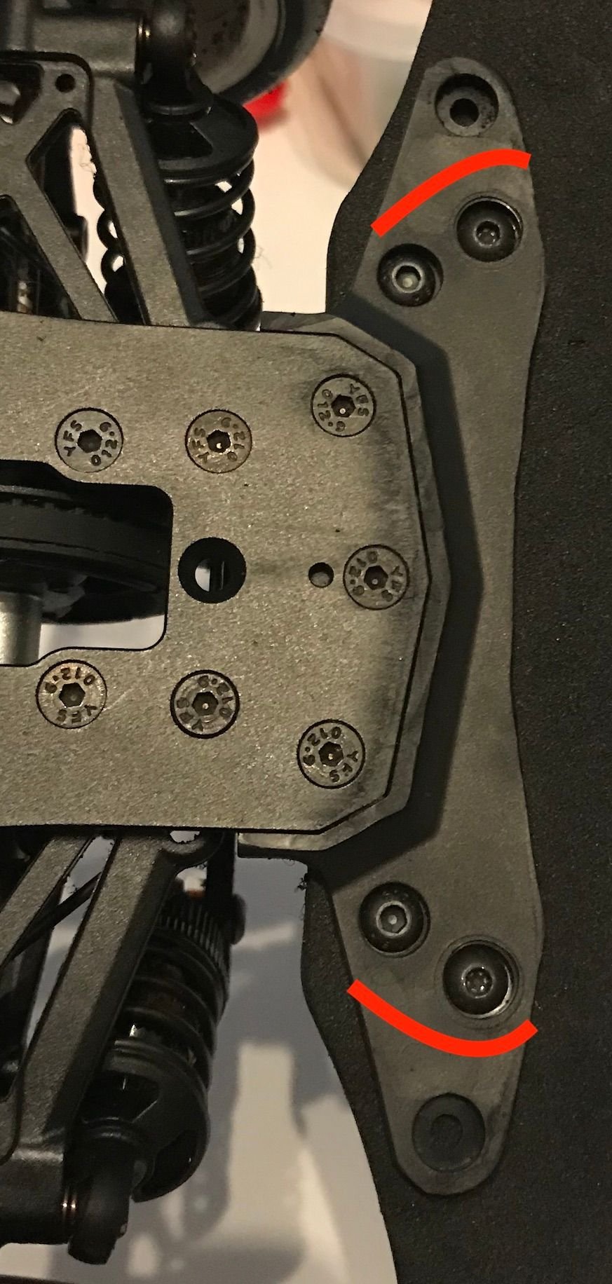

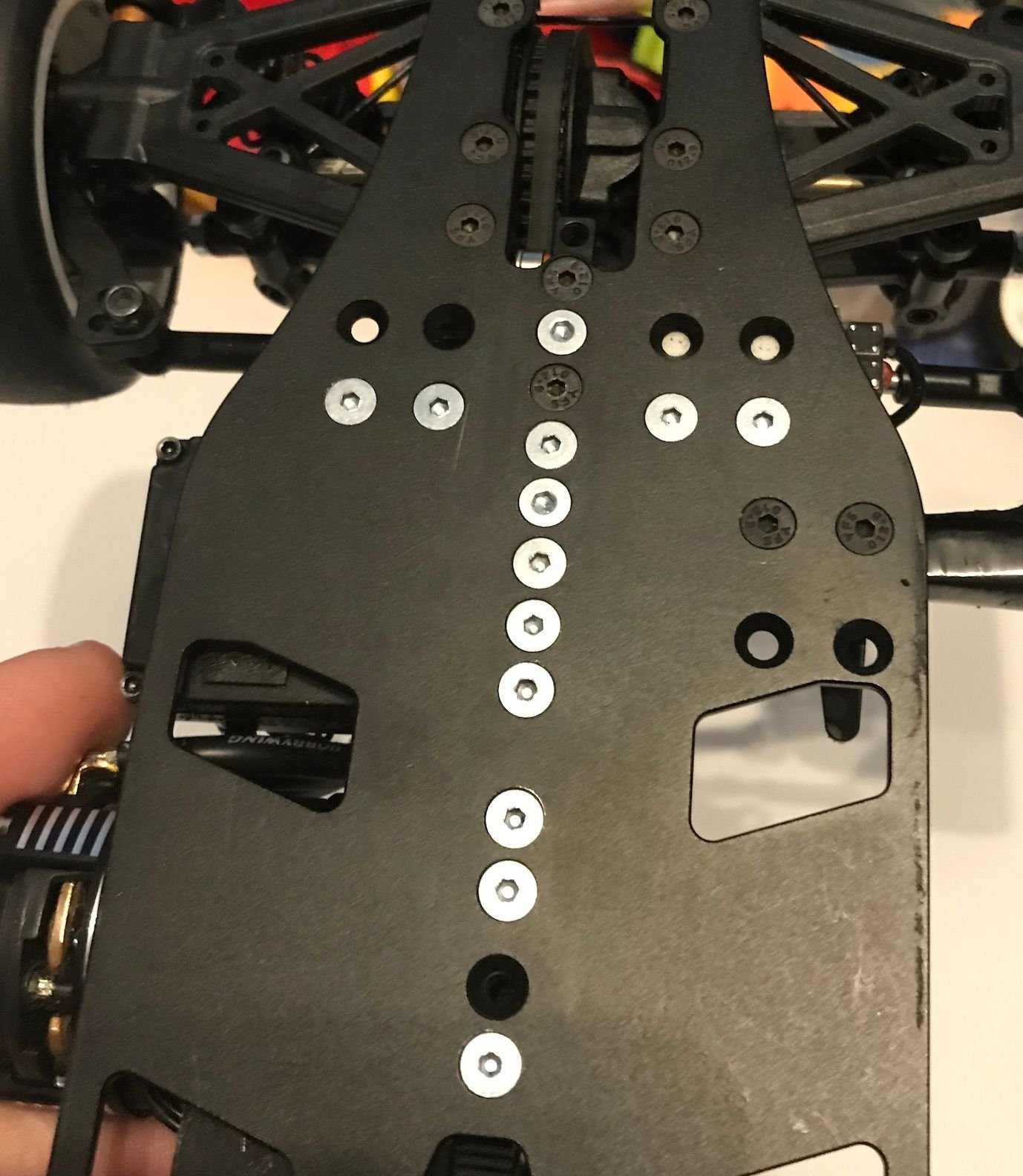

Hi, Here is my chassis bracers. It is made from PLA. It helps little bit, but it is too soft. It is first version. Next version will have more material and I have plan to use another material, which is harder. I think that I will put it somewhere on web after I test another version.
Next thing is to cut the bottom bumper holder. I already cut it, but it is needed more. On one picture is red line, where i plan to cut it, because I have rubber on it from carpet, when it touch ground in corners. It is definitely not good.
I try add more shims under front upper arm holder and less in the rear to help again traction roll. But best thing is, to reduce steering lock. (Alex Hagberg wrote about this on FB today) I change it on radio, because if you realize just before start, that you have problem, reduce steering should help you do the current round. On last race, I reduced by 10% and it help a lot and I have no problem with understeer. I don't like to use glue on side of tires.
Are you running the ETS tires on the ETS carpet? If your on CRC black you pretty much have to glue the sidewalls, but if your on ETS carpet, besides getting the car stiffer, I would put 30 grams of lead in the nose of the car. Right in the front bumber, cut a notch out for it. That alone will do miracles.
I think that it is ETS carpet. I dont like glue sidewalls. The behavior of the car is different and you cant then use tires next time on lower grip for practice.
Thanks for tip with weight, I will try that. I have weights under steering lever, but I understand, that more in front before axel help.
For me was miracle with reducing steering on radio. I will also prepare some wider shims under ball on steeringrack to limit end lock, which use Alex Hagberg on Xray.
https://www.facebook.com/alexander.hagberg/posts/3083531701675687

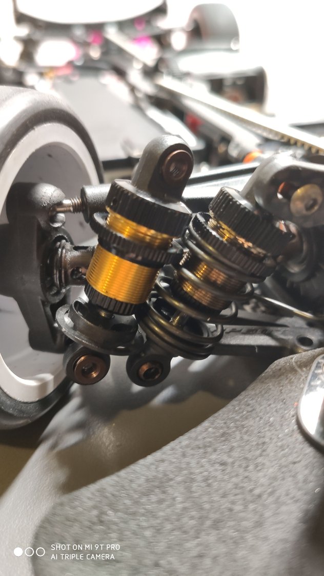

Is this a runing change?
Are from my second car:
Not seeing it.....what is the difference?

Uninstalled shock is slightly thinner in diameter but longer
The measures are the same, only change the bottle color, feel smother whit the pistón then the previus damper
