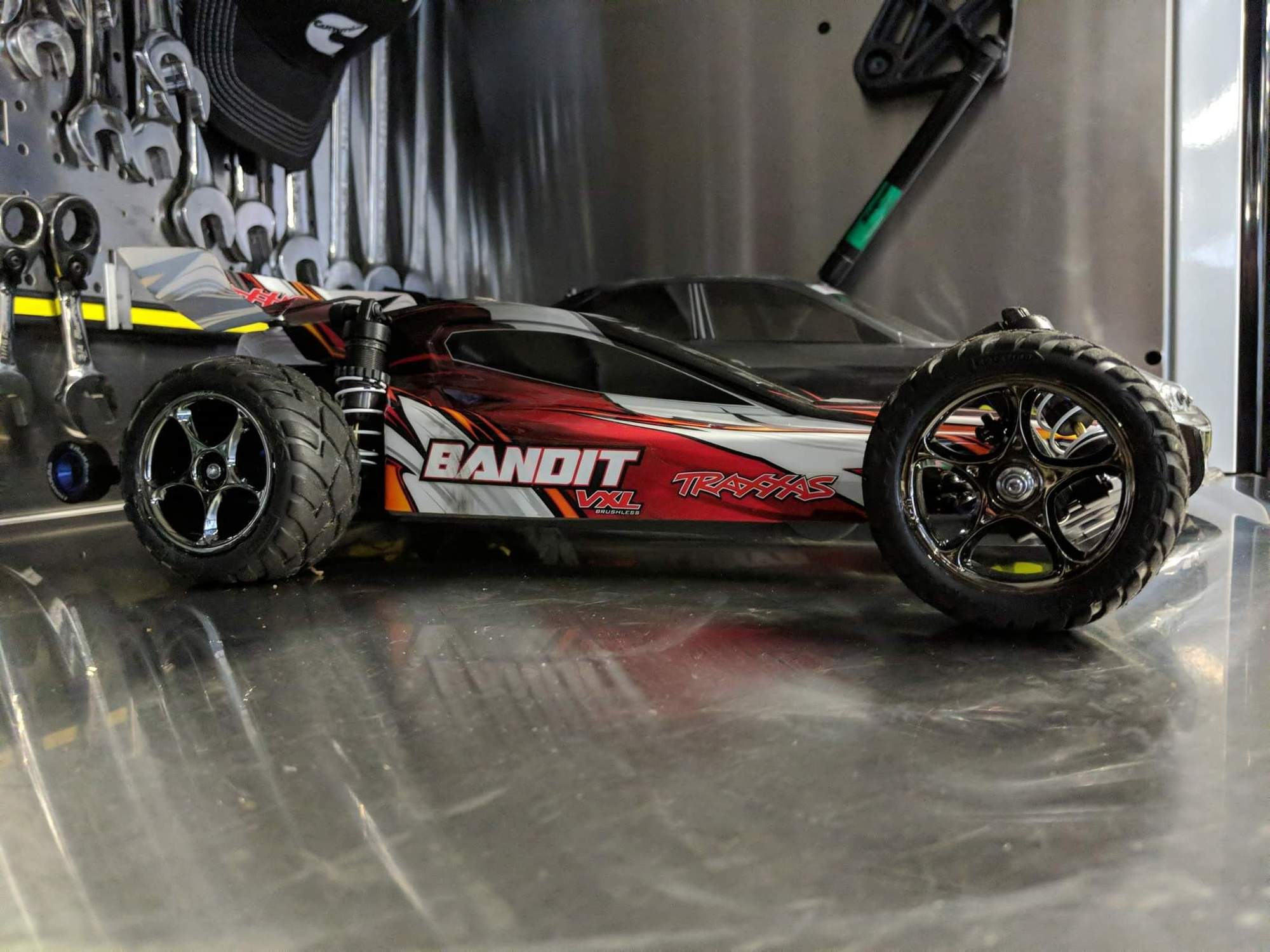

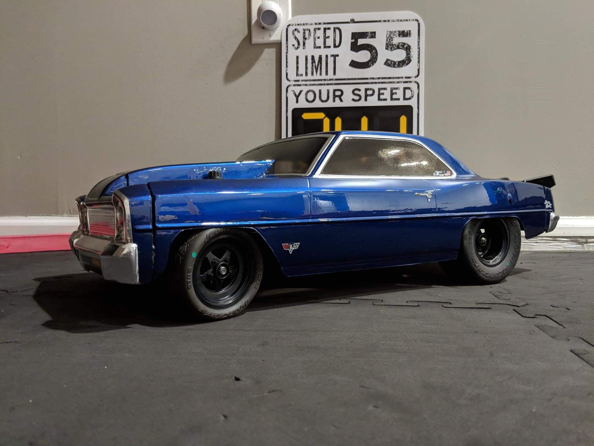

There are two drag cars amongst my friends. One is a Jconcepts Street Eliminator build according to their website. Mine is built off of a Bandit. Both cars use upgrade parts from RPM, HR, Traxxas, and some Jconcepts stuff.
The Bandit looks stock aside from the GTR shocks, and it sits ridiculously low.. lol.
As far as bang for buck, I'd say either a slash VXL, or Bandit VXL. It would all depend on what stipulations your group applies to the build of said drag car. Nobody was a fan of my Bandit. I refused to toss a full fendered body on it.

Bandit runs straight and true. It's probably the lightest of the bunch, maybe except for the ECX pile of junk the one guy ran. On 3s it was difficult to keep it straight with an open diff, so in went the HR locker. Most runs I'd be either top or second depending on how the launch went.

​​The Nova is the JC Street Eliminator car. I used a lot of the ideas from their build for my Bandit.
