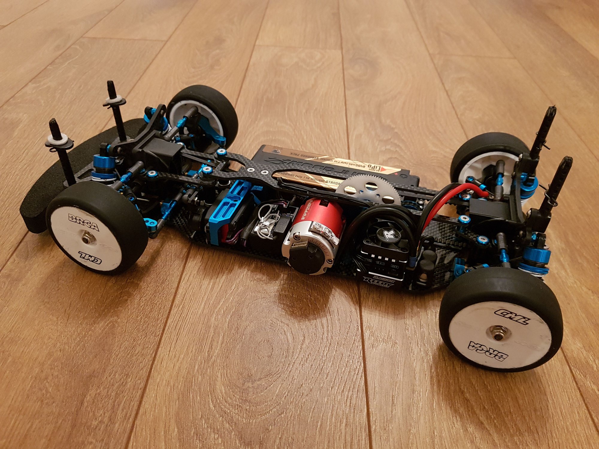

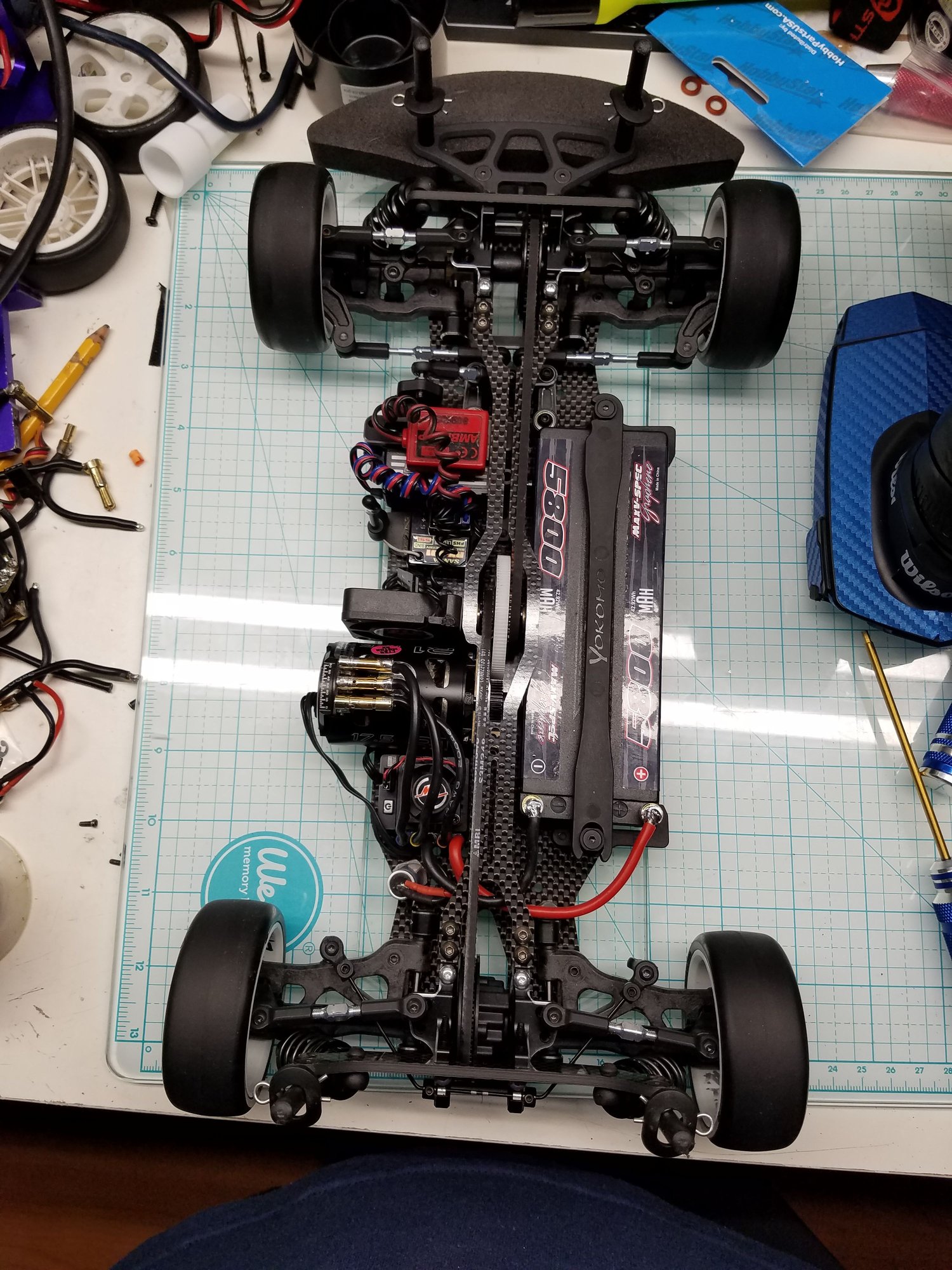

Interesting... that is one heck of a serious setup for a 21.5 class. The battery must be pretty reliably and snugly maintained to the chassis with this mounting system, right?

Yes, USGT 21.5. The car will also be used for TC. The big battery was part of the reason for choosing the carbon Medius kit. The BD9 battery hooks and strap are very good.
