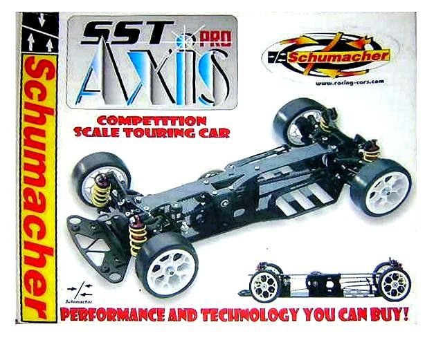

Loved the Schumacher SST Axis Pro back in the day
