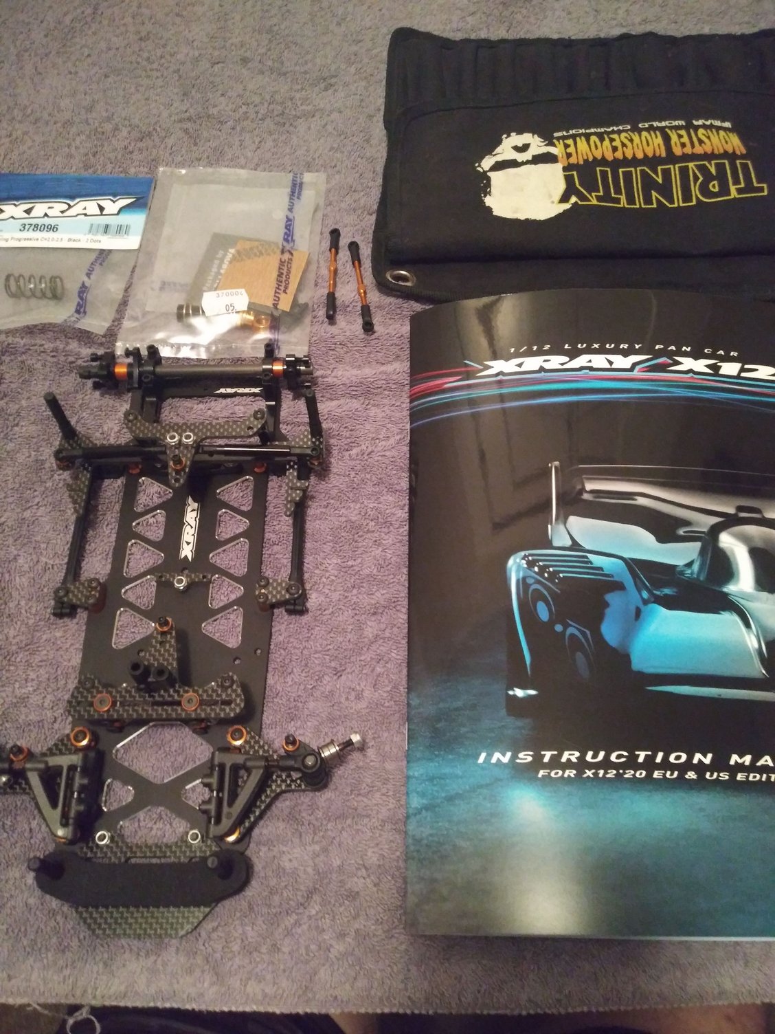

Just finished 75% build. Went together super smooth. My 1st Xray. Starting with Robbies setup for stock post above. Looking forward to returning to the track

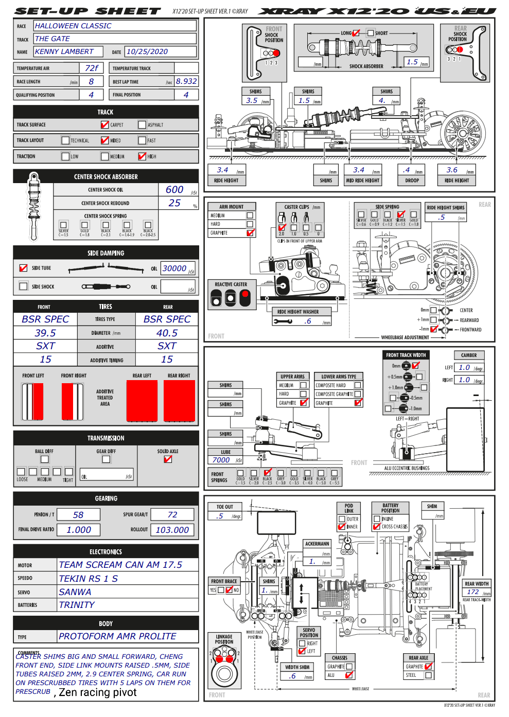

This is setup I ended up running at the Halloween classic. Very easy to drive.
