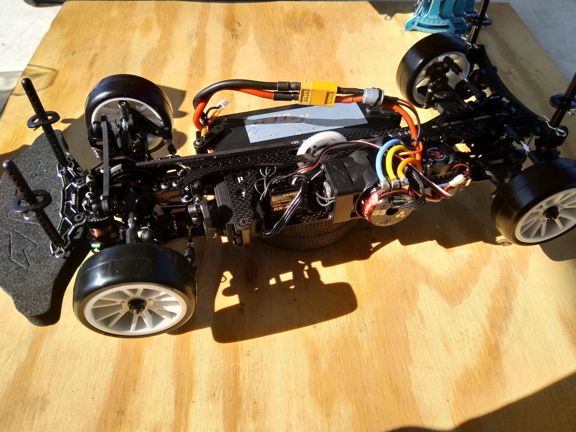

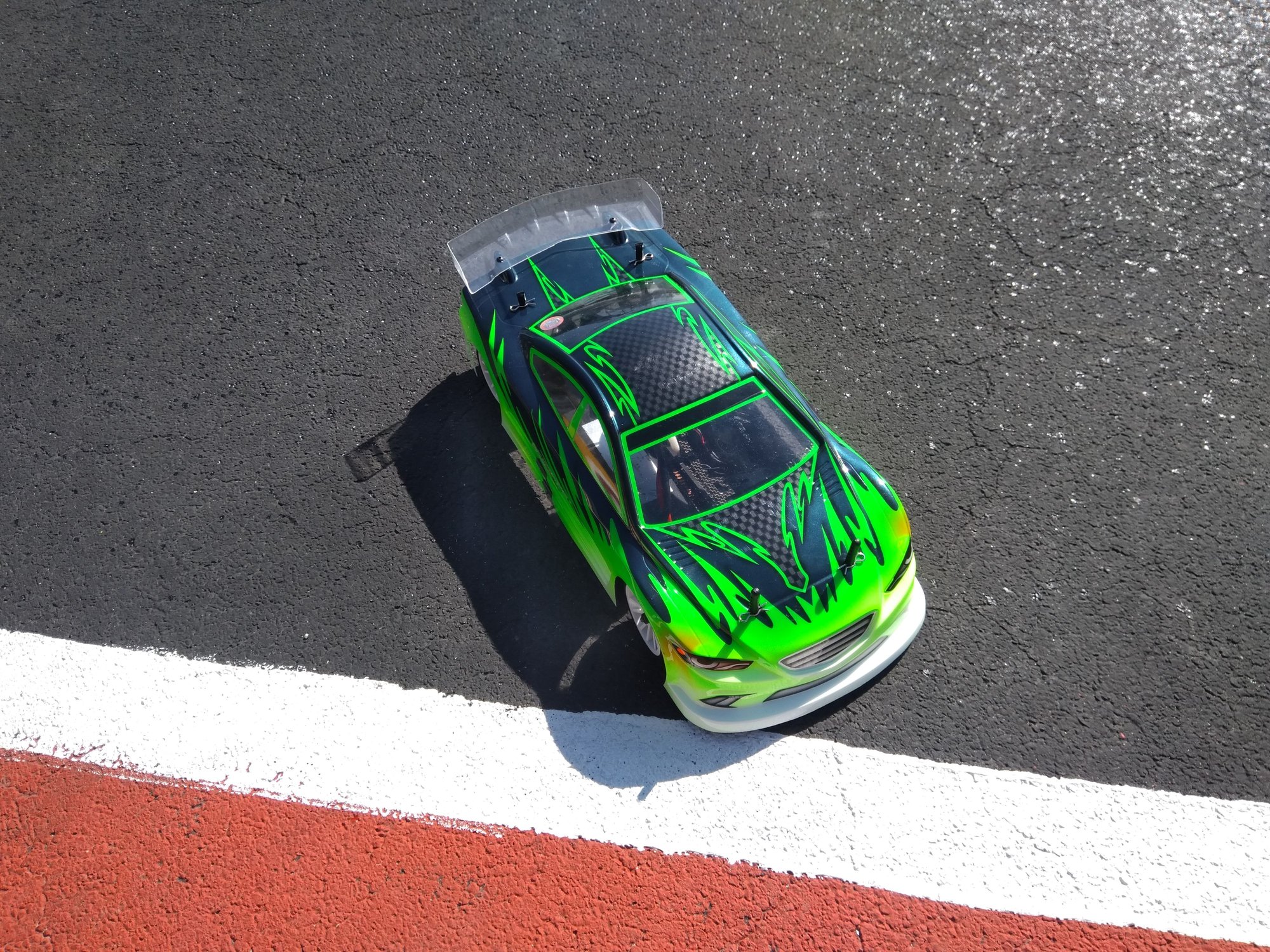

First time out on asphalt using as close to as I can get on kits suggested asphalt setup 17.5 stock touring car
Ran good, finished 5th out of 5, I was running with all the top guys (I was little out skilled)
I think I'm having a drag problem from the front belt tensioner (the bearing bolt is rubbing on the spur.

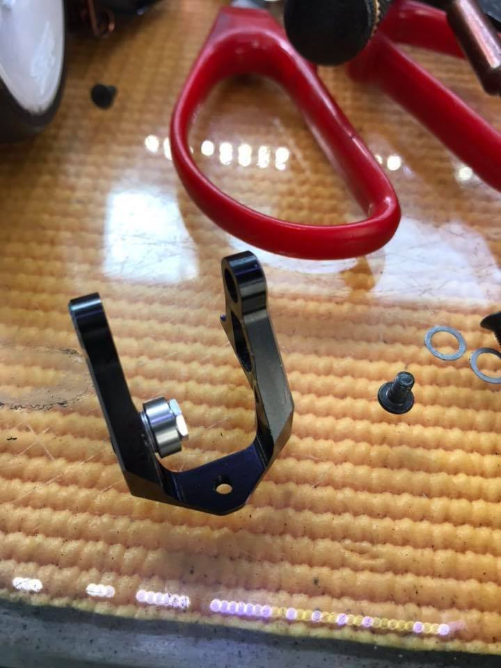

The only problem I've has is a slight bit of drag from the bolt rubbing on the spur gear from the belt tensioner mod. I either need a thinner head bolt, or I'm going to try using the steering post mod. At the track I race at, if you tag the side wall, doesn't mater what you drive, you will be replacing parts. I did pick up a spare set of arms just in case. I sanded and glued the sides of the chassis. I would buy this car again in a heart beat over the $ray.
1.Advance 20M steering post x 1 ( trim shorter 3mm)
2.M4x0.2 shim x 1
3. M4x 7x 2.5 bearing x 1
4. 3 x 8 set screw x 1

Check your bearing thickness. Also depending on the spurs you will need to take out the spacers on the top shaft.

I got that pic the 3racing facebook page.
I'm using the 3x8x4 bearing with a 3mm button bolt, and a .02 shim.
Also running a panaracer-Xenon 96t spur

It might be the xenon gear being they are thicker than the axon. Try going to a 3x8x3 with the .2 shim.
