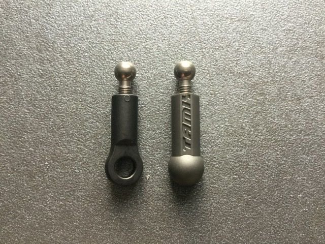

Is there a preferred tool and/or technique to install, remove and free up the sway bar mounts in the arms? I've just sacrificed my first arm when attempting to remove a 'too snug' ball end from the mount....
I'm actually pretty surprised that they didn't use a metal ball for that lower mount..especially considering some of the other steps they have taken to keep things free and smooth...

You have to trim it, I just sanded mine down till free

Does anybody have any tips or techniques to remove the ballcup from the arm if it isn't quite 'free' enough and needs to have more removed?
NVM....found a pair of long thin, tapered tweezers that can slide and and ease the cup off the ball end...
For making the ball cups fit on the TRF420 front arms, I used a ball cup reamer tool made by SQUARE (Part# TRX-41) to work on the ball cup instead of sanding the ball on the arm since its not very accessible. The tool has a cutting ball head with adjustable expansion to trim the inside of the ball cups.
Alternatively, you can use a body hole reamer to trim on both sides of the ball cup, removing material from the "collar" so it doesn't grab so tight onto the ball. The advantage of the SQUARE tool is that it trims from the "inside" of the ball cup (due to the ball shaped cutting tool), rather than from the outside with a tapered tool like a body reamer. A body reamer will do the job of freeing it up but sometimes making it pop off easily as well.
5mm?????????? 5mm ball end reamer | ?????? | SQUARE ?????? -PRODUCTS-
For attaching and removing the ball cups, try using the end of a pair of tweezers (the flat, wide end) and insert it between the ball and arms, it works as a pivot to leverage it on and off of the arm.
EDIT: Thanks, your method works well for removing them.

I didn’t sand the mounting balls on the arms for the tight-fitting sway bar adjusters, but instead used the 54257 adjusters. You have to trim them down a little to match the size of the kit adjusters, but they fit well on the balls without sanding, and have free movement with no slop.

all i did is trim the seamline with exacto knife and mine are fine
