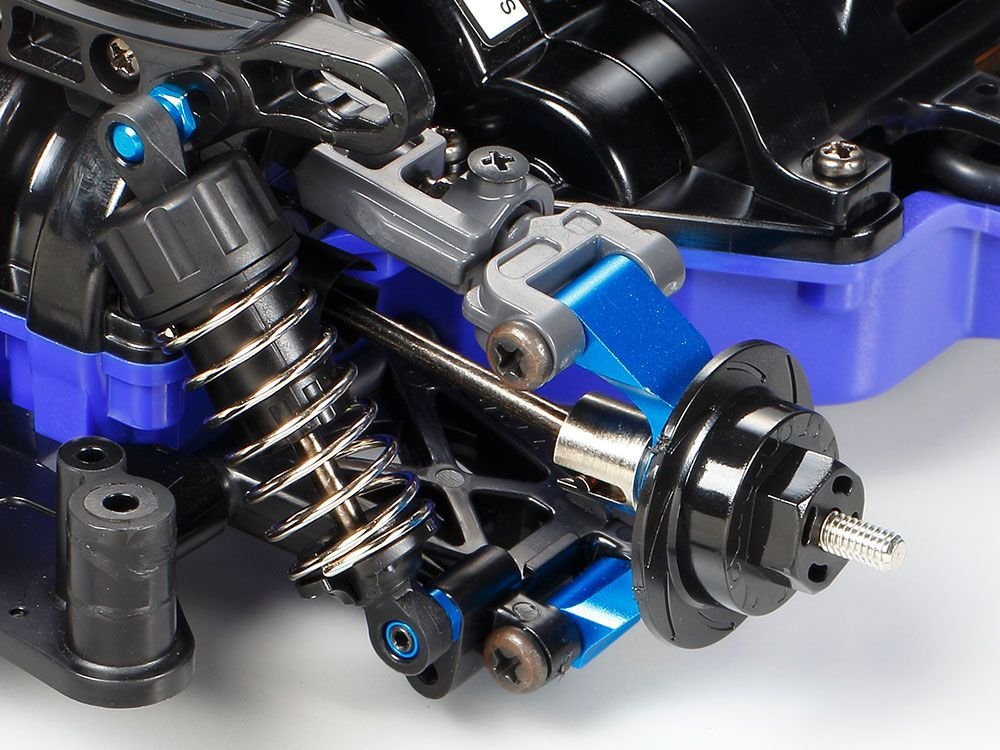

I didn't say that the R has "more" tunable suspension. I said it also has tunable suspension as compared to the stock upper suspension arms of the other TT02 kits. Also aside from the center shaft, it also has aluminum motor mount, aluminum rear uprights and others.
Here are the features of the RR (from Tamiya site)
★Aluminum Rear Uprights (3 Toe-In) ★Aluminum Motor Mount ★TT-02 Aluminum Propeller Joints ★TT-02 Aluminum Propeller Shaft ★TT-02 High-Speed Gear Set ★TT-02 Full Ball Bearing Set ★Metal Drive Shafts, Wheel Axles & Gearbox Joints ★4mm Aluminum Flanged Lock Nuts (Blue) ★5mm Aluminum Short Ball Connector Nuts (Blue) ★5mm Aluminum Ball Connectors (Blue) ★Medium-Narrow Racing Slick Tires ★CVA Dampers & Springs ★Oil-Filled Gear Differentials ★Adjustable Upper Arms

Though I've not personally had one looking at the suspension designs I'd go for the TT02-S
The R's use a design derrived from the standard TT02&1 style suspension with added adjustability
wheras the S uses the same suspension arm and hub layout at the TB04, that is TRF416/7 arms with 418 hubs
I'd think for most use the turnbuckles on the S are easier to adjust than the RR's upper arms as the suspension layout offering more options for being able to add roll centre shims.
I will admit I don't quite understand why the S isn't realsed with the ally prop and oil diff of the RR. However I think the S's suspsenion would have far more potential and fitting the alloy prop and oil diff to an S would be a less drastic change than reconfiguring the suspeion of the RR to match the S

This question is not easy to answer.
The "S" has the better suspension, but lacks a lot of the "RR"'s useful tuning parts:
54500 TT-02 High-Speed Gear Set (68T) (allows you run other spur gears as well, including 48dp and 64dp - in combination with another motor mount)
54501 TT-02 Aluminum Propeller Shaft
54502 TT-02 Aluminum Propeller Joint
and either
54558 TT-02 Alu Motor Mount (Tamiya) - (not fully adjustable, but original Tamiya part - may play a role for some rules)
or
Yeah Racing TT02-013BU - Tamiya TT-02 - Alu Motor Mount - (fully adjustable)
So far, these run for about 40 over here, which is about the price difference of the kits over here as well. The "RR" still has some blue anodized alu wheel nuts, turnbuckles and such, but the "S" has the better suspension at this point. (A little less bling, but more performance.)
But then, the RR still has the harder blue chassis and sealed, oil filled diffs on top. The diffs run for around 25 each - no idea about the chassis (but it's not legal in the racing series I would use a TT-02 in here, anyway).
My personal choice would the "S", as a base, then upgrading the necessary/useful parts, but your mileage may vary.
Those upper suspension links look very strange. Why are they so complicated? Are they stiffer, or are they harder to knock out of adjustment, or is there some other reason, or is there no good reason at all?
LOL, only Tamiya would include aluminum wheel hubs alongside phillips-head screws and dogbone axles. What are they thinking? Anyway, I generally don't use aluminum wheel hubs, though I do like aluminum caster blocks, especially if I can find ones with ball-bearing steering pivots.
