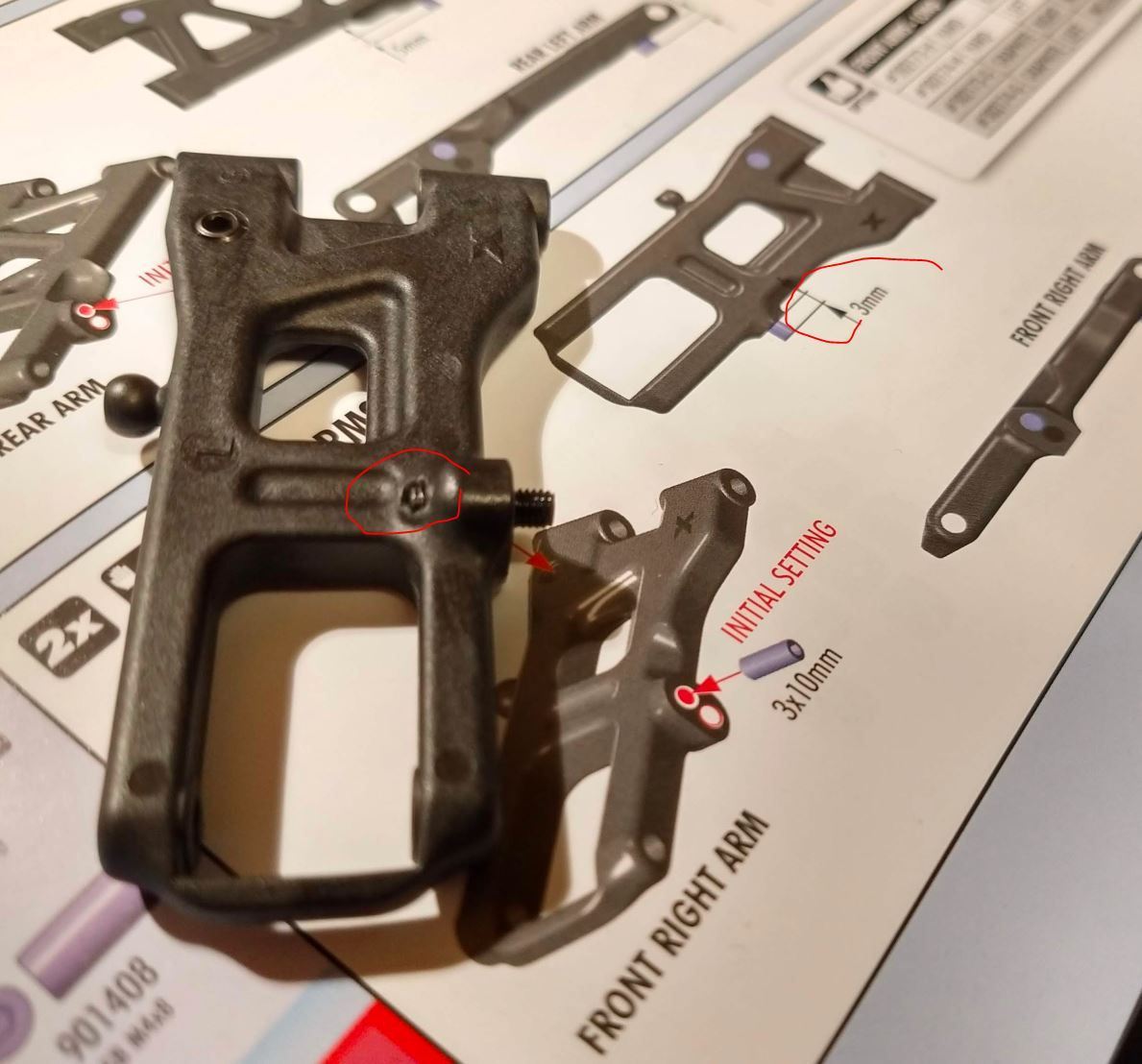

I believe there's a funny in the instructions: this should read 5mm... because 3mm out only is a bit too deep

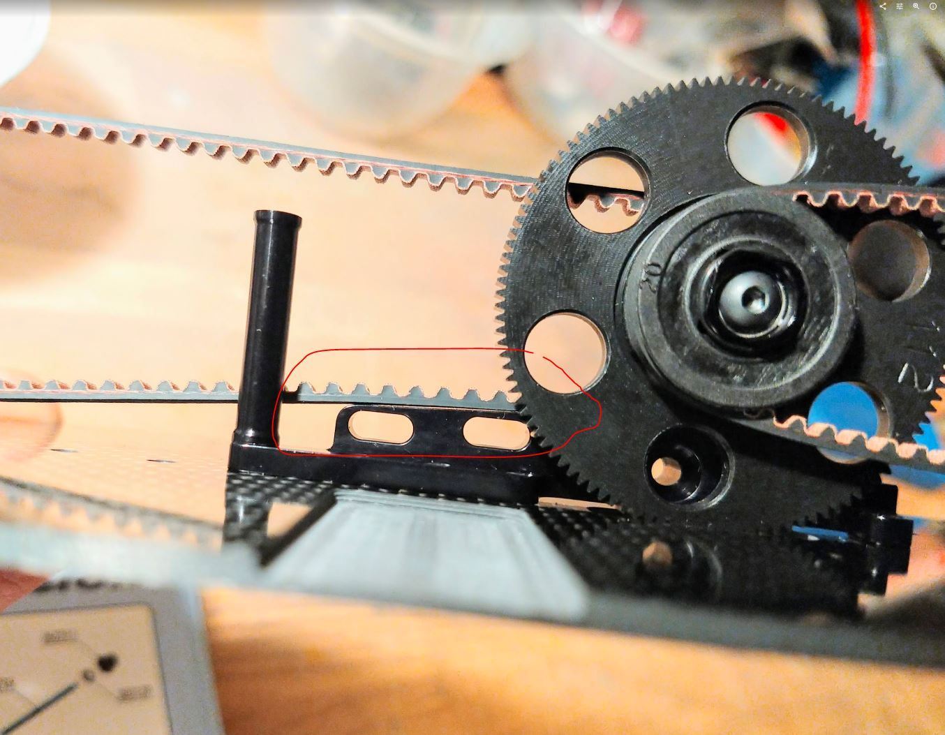

Additionnally - shall I feel concerned? yes, floating bottom half of the betl when accelerating... but not when braking.

I know the manual says (and are supplied in the kit) 10mm grub screws for the front wishbone shock mounting, but it only needs 8mm at most.

Cheers Robby, makes sense. Any comments on setup starting point? Thank you!
