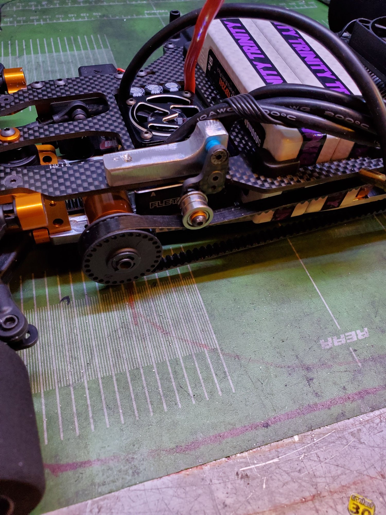

Does anyone have issues with the tensioner on this car? I am having a custom aluminum mount made for mine. Also, what do you do on batteries to keep them in place? I am not a fan of tape. Wondering if velcro or other solutions

I don't bother with battery hold downs - they seem to stay in there. I have my motor wires routed over them so that may help.
Not a fan of the tensioner - seems like it needs some more adjustment/travel but I have not done anything about it

Probably overkill but a friend made me a mount with adjustment.
