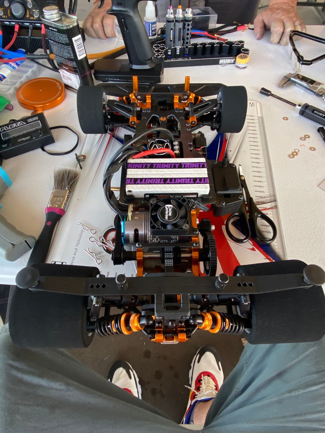

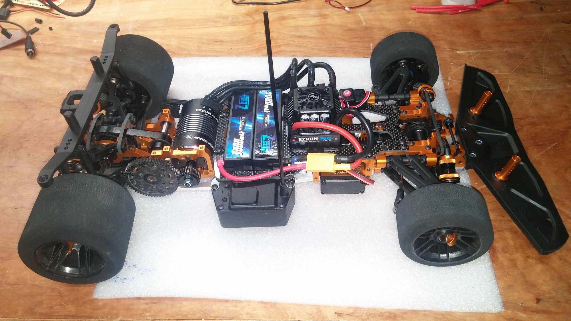

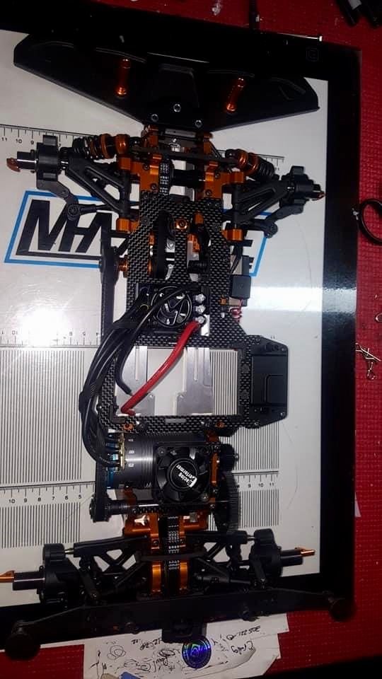

It is very limiting on motor choice - the only thing I had on hand that would fit was a Castle 2650 - I have not shopped around but 68mm seems to be the limit.
Shorty packs work - I have been using Turnigy Graphene 4600mah - they are a tight fit for width - tearing the labels on removal so I removed the labels completely. Wish they had left another mm or two for pack expansion over the run - might make them easier to remove from the car. I run an eGT while it cools
https://hobbyking.com/en_us/graphene...connector.html
As these packs have through connectors I made some double adapters to I didnt need to mess about with the wire under the car:
https://photos.app.goo.gl/hWgiLSZzaMYkX1Vt5
These packs also work and are a little thinner - fit more easily. I left 4mm bullets on the ESC and use adapters for the Graphene packs:
https://hobbyking.com/en_us/turnigy-...-approved.html
My Tekin RX-8 fits in there with careful placement - a Castle MMM will also fit without the fan - I run them like that all the time in 6s truggies so I am sure it would be fine.

Before I made the through connectors I just ran a wire between the packs before putting them into the car - so the wire ran across the bottom of the packs. No Y on the ESC

Got the car wired up with the new packs. Is not as terrible as I thought it would be. I need to put some foam on the chassis to pic the batteries up just a bit, right now they hang on the connectors. Then put the Velcro strap back on.

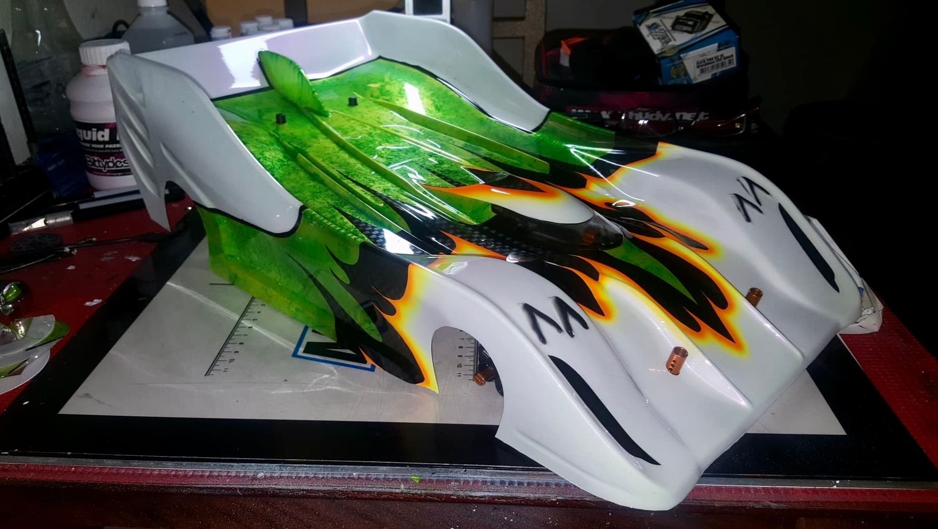

I doubt I will get to race mine at my track so probably just play around. Does anyone know of any body that fits besides a wedge? Was hoping something modern like a Corvette or really anything sporty.
thank you!

I have no idea what other bodies might fit - and I am more interested in the downforce that I am in what it looks like. There is something about driving a car with decent aero

I have gotten bodies from here, nice selection. Look at the 1/8 on road bodies.
https://deltaplastikusa.com/
