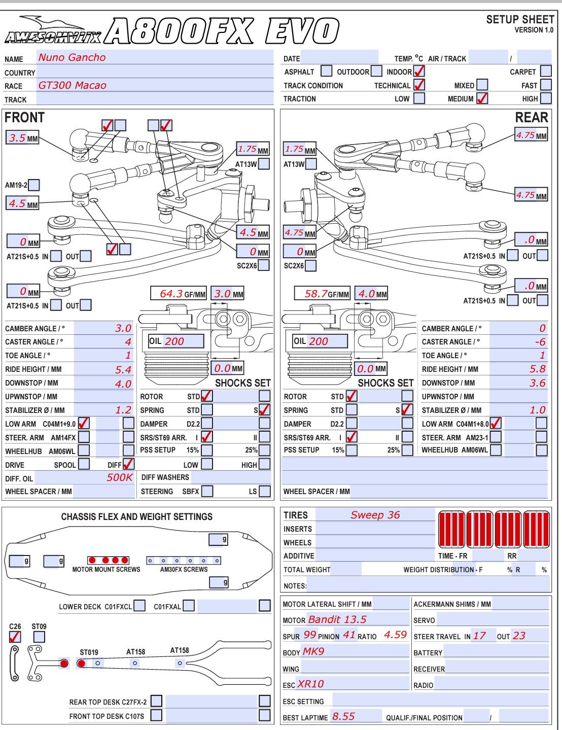

after long testing updated setup sheet.
The car needed more droop basically is was to stable. Still need softer upper deck but believe it is not available.
have anyone cut the rear upper deck?
beat lap from 8.8 ended on 8..55

Try C27FX-L Topdeck.

Soft upper deck--
A800FX-C107S
A800FX-C107S
C107S Front Top Deck Soft FX ? AWESOMATIX

C27FX-L Topdeck that looks good without front motor mount screw
C107S that is original from Aluminium. Car kit
if I cut C27FX between both rear ST019 mounting holes will it allow rear to rotate faster?
